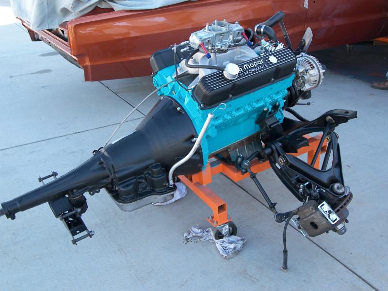

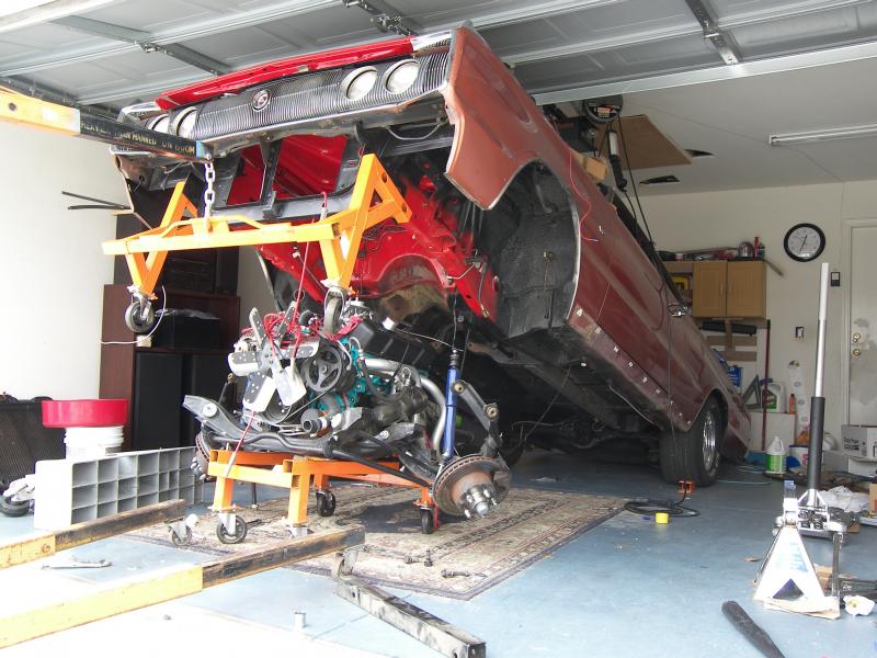

Install with suspension-Engine-and Trans :eusa_dance:
View attachment 259489View attachment 259490
