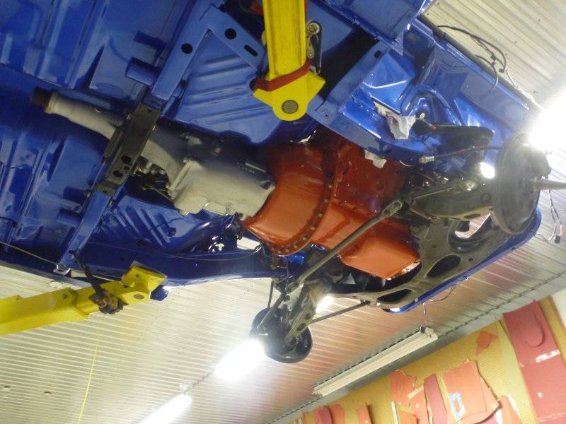

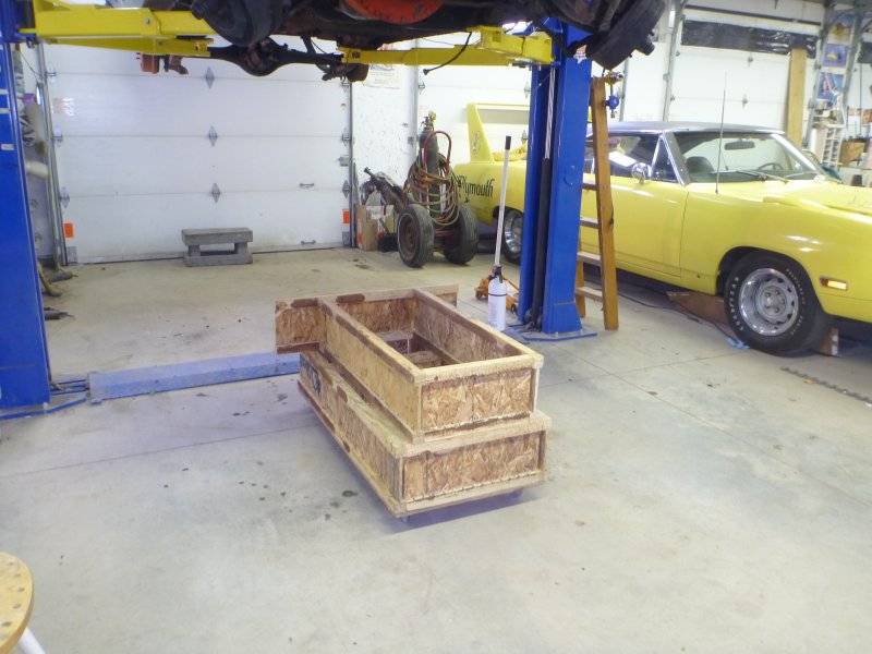

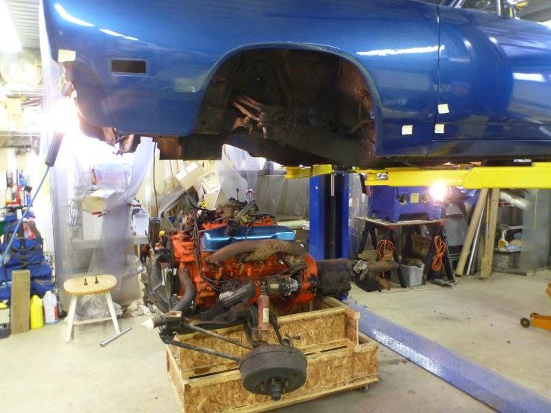

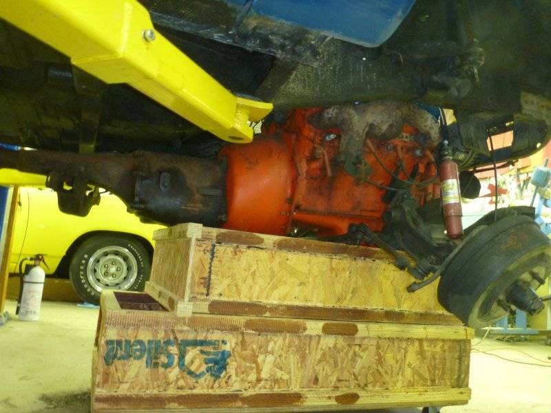

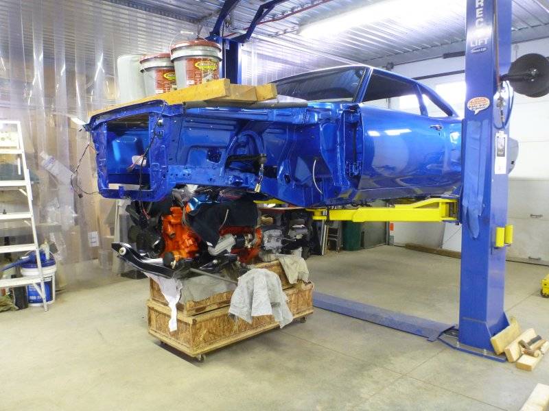

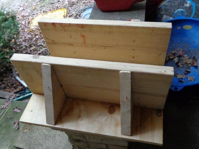

I'm assuming you're referring to the engine cradle/subframe with engine/trans already mounted. Sure you can build a wood dolly with casters, we had that many, many moons ago. Just use sturdy wood and weight-rated casters.
not mine but an example.........

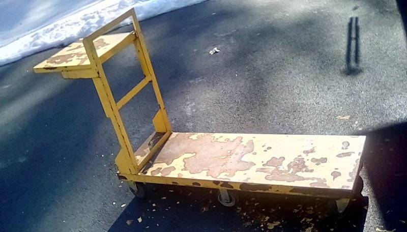

Made mine from a heavy duty cart (think HD or Lowes) I found on local for sale. Did some minor fabrication.
