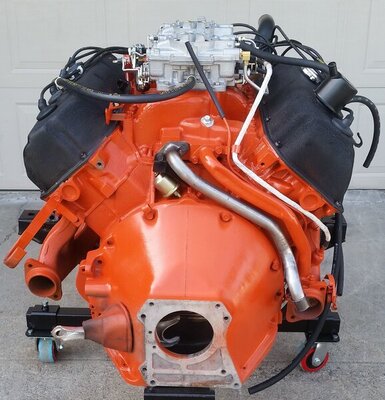

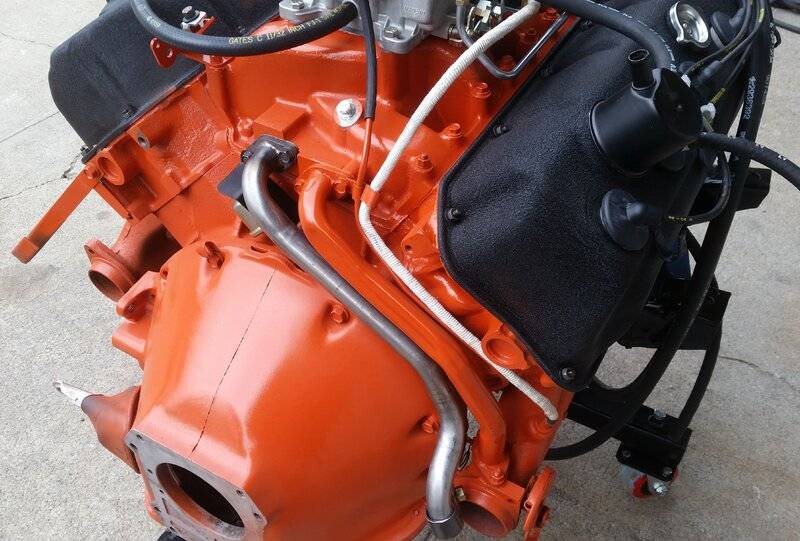

You should be able to get them in. Here is what it looks like without the car in the way.
Look at the throttle cable bracket. It’s a auto with the pin removed on a 4speed.

2B600A90-F06F-4D8D-8CB6-7E9D00AEF6E9.jpeg 56A8D78B-4C75-4FFE-BF50-A1DBB4EE5788.jpeg
Thanks for the picture. Not sure but the hood may keep me from being able to stab it in from above. From down under looks to be a real problem.
The picture shows a clamp up at top - although the one tube is there I bet I'm missing that clamp.

I’d go from bottom up. These are tricky, everything is filled up.
Got it in. I flattened out some curves slightly and worked it in from top side working outside the heater hoses and once down below the manifold - rotating it under the heater hoses and behind the motor. I think straightening the curves a bit actually may help it fit better but I need to get the clamp brackets to secure them at the back to finish it up.
