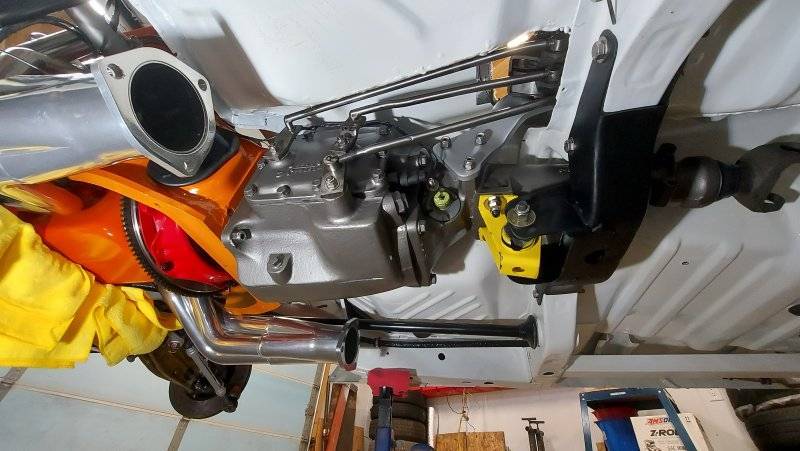

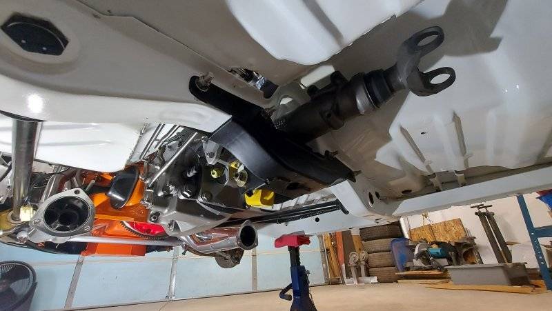

oldkimmer, I assume that you have the 'dog bone' adapter.
That will not extend the shifter to the rear.
B-body tail housings have 2 mounting positions.
The dog bone will place the shifter between the 2 positions, like so.
Look at the second picture, you will see the rearward mounting position. It is visible in the first picture too.
