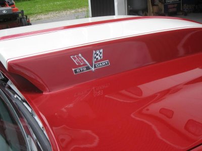

i just had a glass scoop put on a steel hood by an old body shop owner and he says it will last. it is sealed and looks pretty good. he is the go to guy around this area and has done some other stuff for me thats lasted. how? i didn't ask, but if you want to know, i will. he also filled in the air vent slots that ran along the back ridge. i think it looks pretty good. buying the scoop and install ran about a g-note.:headbang:
p.s.; its not mopar but it is what it is.

The blended in version will be only as good as the hood is strong. Once you cut the bracing for the opening, flex will take care of your blend job. The Dart pictured above has a smaller hood, less area to flex-the bigger the hood (area) the less likely you are to succeed. This assumes of course that you plan on it being a functional scoop.

i bought a steel satelite hood that had a 6-pack hood scoop put on it.It had been glassed over the edge of the scoop onto the hood and is starting to crack thru.So i will have to repair that before i paint it.Bought it from another member here but i'm still happy with the purchase.

That looks great Rick! May not be a Mopar but thats a good job whoever did it, heck that would look good even on a chevelle ;) 70 possibly.
