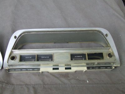

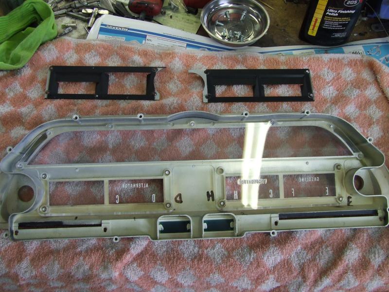

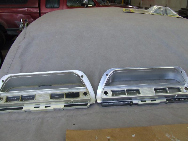

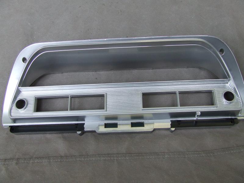

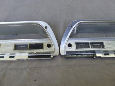

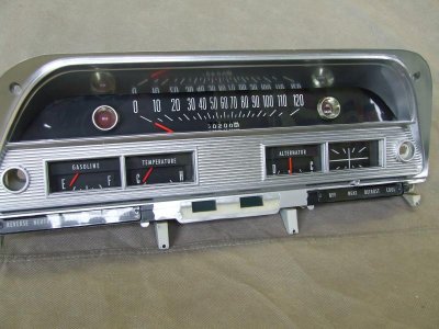

I guess it depends how much money you want to spend. I rebuilt my instrument cluster this winter on my 63 Dodge. I touched up the needles with fluorescent orange pant and the chromed portion I sanded any rough spots, cleaned and sprayed with palstic adhesion promoter. Then primer and Duplicolor chrome paint. It isn't as shiny as chrome but looks more like polished aluminum. It is very presentable and my Polara is not a trailer queen. The first pic is a side by side of old and rebuilt. Second pic is completed cluster. Last pic is the old cluster. DSCF0487.jpgDSCF0488.jpgDSCF0486.jpgDSCF0485.jpgDSCF0484.jpgDSCF0483.jpg
