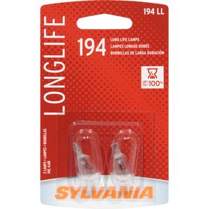

The instrument bulbs (the bulbs that light the instruments, aka: gauges) on my `66 are of a socket type...each bulb goes into a black plastic piece that has brass(?) tabs on the mating edge. Each plastic piece rotates into their respective holes on the back of the instrument cluster. They get power via the board they rotate into. Pretty sure these were used up through `74.
This is the plastic socket
https://www.google.com/shopping/pro...a=X&ei=_ySbU_XpMojisATBxoGoBg&ved=0CDUQ8wIwBw
Bulbs can be picked up at any parts store
my cluster. is on a 70 charger with the rally dash. I bought new 5/8 twist sockets for the 194 bulbs, they dont fit very tight, as a matter of fact they barely take hold at all probably bought cheap pos chinese crap. the volt limiter was hanging free when I took off the dash, isnt it supposed to be secured to the metal dash frame?
