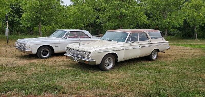

This is the 64 Fury wagon I am working on. Sat in qy for 30 or more years. We have about 1000 miles so for this summer. I just sold the 64 HT in the picture
The picture I forgot to send
