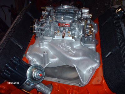

Does anyone know of a "modern" intake manifold (Edelbrock etc) that will fit a 383 4bbl and still allow the hood to close with a stock 69 air cleaner?
had an old performer on a 68 charger that worked fine with the stock magnum sealed aircleaner.never measured anything though.
i have no problem with the intake and carb in the pics

If I'm reading this correctly it sounds like I should be ok with buying the Edelbrock Performer Aluminum intake?
Isn't the Edel. Performer the same intake only in aluminum?
If you are referring to the pic above then no, it is different. The one that appears to be an exact mach to a factory iron intake is the MoPar M1 dual plane. The pic above looks more like the old DP4B or CH4B design from the 60's.
I recall seeing the performer having a different shape than the one pictured above. Perhaps the one above is a new version?
solution to my Problem
Thanks to everyone who responded to my original post...what I ultimately discovered is that a stock air cleaner element is about 3 and 1/4 inch tall. I had a Performer RPM which prevented the hood to close. I found an element that had the proper diameter but only 2 inches tall. That inch and a quarter was enough to close the lid comfortably.
