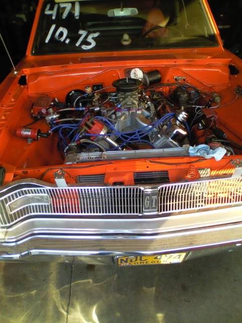

67 Dart.
440 ci.
Eddy heads.
M-1 intake.
Hugh's 590 cam.
Off the juice.

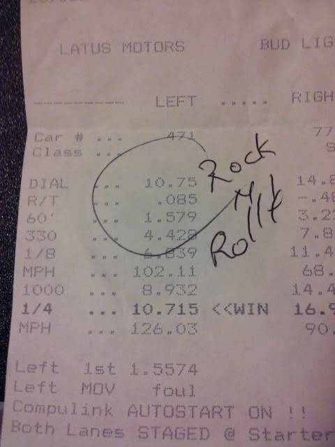

Womanator I am curious as to what gear and converter you have in the Dart as its 60 seems a little soft. Here is my 60 on an et about the same as yours and I am using the Indy dual plane ? Is that your best 60 ? I use a cam very close to the .590 as mine is .585 and .592 lift. My 60 is a bit better then yours but you have a bit more mph. Ron

Ron,
I'm running a 3500 stall.
Leave the line at 2000 rpm's because that car has street tire's
With slick's the car has a 1.39 60 ft time.
4.10 gears with a spool.It's chirpie on the street.

Wow thats a big difference ! Very nice 60 ft.
