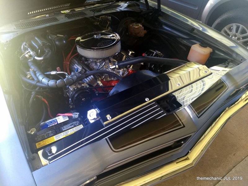

Right. I don't think they make one for a Mopar, yet. SO, you have to fab one yourself, for now.
Here's the Undercover Innovations cover on my daily driver 69 El Camino.
