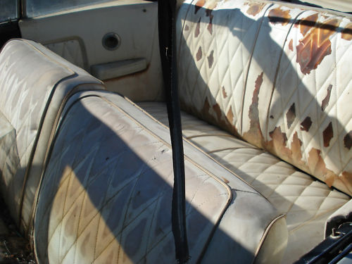

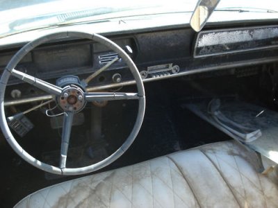

Dash pad, steering wheel, column, and carpet are all blue. Spoke to the previous owner. Here is a pic of the seats and doors

Notes and thoughts...
There was not a blue and white combination or black and white combination for a 67 Belvedere convertible.
The seat pattern is wrong for a HB4 interior. In fact there is no white bench seat available for a 67 Belvedere.
White (P6W) was available for RP (Satellite) and RS (GTX) convertibles which would explain the white door panels and rear quarter panels.
My opinion and thoughts: this is obvioulsy not an H4B interior. If the interior was special ordered from the factory to include the P6W parts, the trim code would probably be 999. If this was a special order interior, but not coded 999, what pattern was used? I can't find that particular design in any 65 or later Mopar parts book.
I believe someone somewhere changed the interior after it was delivered from the factory. I'm not sure that is even a Mopar seat pattern.
The VON may give us another clue. What is it as I can't read it in the picture. If it starts with a "0" that reinforces this interior is NOT factory installed.

That seat material looks to be cloth and vinyl and the pattern is a common aftermarket typical upholstery shop job. Many people had the standard vinyl interior in converts reupholstered in cloth because the sun made it too hot to sit on.
You are right in correcting my previous post about the blue/white combo not being available in the 67 Bel. I was looking at GGs white book which of course is inclusive of all models and does not really break it down per model in many cases.
The H4B interior on a 67 Bel convert is a two pattern all vinyl interior as per the link below.
http://www.hamtramck-historical.com/images/dealerships/colorAndTrim/1967/67_GTX_Belvedere0004.jpg
The interior in the pictures above in my opinon is definately aftermarket. It MAY have been done at the dealership BEFORE it left the dealership since there was not a factory option for a cloth interior.
