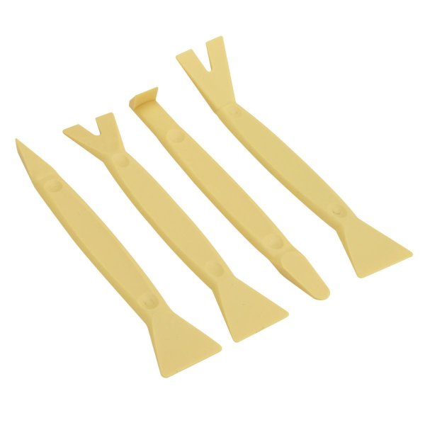

The rear door panel is attached to the body by metal clips that run along the back side of front vertical edge of the door panel. The rear door panel is also held in place across the top and bottom by the pieces of stainless trim. Remove the arm rest, window crank, and back seat. There is a small aluminum piece, about 10" long that runs along the bottom of the door card that fastens to the floor, remove it. Go to Harbor Freight and buy a set of their pry tools, (see attached link and picture). Insert the tapered end of the pry tool under the front edge of the rear door panel. Start at the bottom and work your way up. The clips should stay attached to the door panel and should pop right out of the mounting holes in the body. Once all of the clips have been popped out of the body, pull the bottom edge of the door panel away from the body and slip the top edge out of the stainless trim piece. The stainless trim piece at the top of the door panel as well as the painted metal piece at the base of the rear side window do not need to be removed from the body. Hope this helps.
https://www.harborfreight.com/nylon-pry-bar-installer-kit-4-piece-63594.html

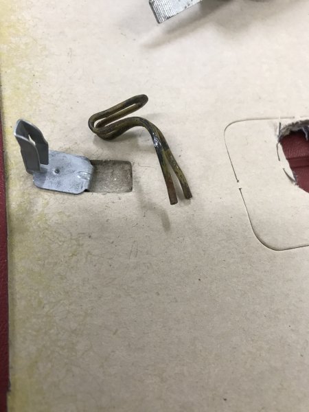

I’m guessing you already have the rear seat cushion removed from the car. The door card won’t come out without doing so. First, the vinyl windlace strip along the door opening needs to be pulled off. There are clips along the front edge of the panel. The top of the panel is usually retained under the lip of the upper SS trim strip. The lower edge of the panel is supposed to fit in a shallow groove in the wire harness metal cover at the rocker, but some replacement panels are a little too long to fit in it. Of course the arm rest and window crank have to come off. The clips will look like one of these. A wide flat, plastic tool like RT6PK showed above usually work. You want to gently pry to locate the clip and slide the tool directly under the clip and then pry/pop it out of the hole. Ih the tool is not under the clip you risk tearing the backer on the panel which may then not hold the clip and may create cause other damage.

I needed a couple of the far left clips. Upholstery guy gave me a couple used on VW’s, looked identical. FYI

I'll add some insight. Another helpful hint when it comes to removing the clips is when slightly prying the edge of the rear door panel to find the location of the clips (there will be a total of 3) squirt some WD40 on the clips to help ease the stress of coming out of their holes. This will help reduce the chance of damaging the backside of the door panel. Also for future removals, take a sharpie and mark the clip hole locations for easier pry tool setup. Also I brush some grease on the metal clips so that I don't have to use WD40 the next time.
