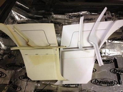

SEM is good stuff! I dyed/painted the interior in my wifes car from white to black 6 years ago & it's still holding up. I'm now doing the interior for a vehicle I recently got from my brother. (Non Mopar) The white interior turned yellow. Now back to white with SEM. The pictures shows the differences.
