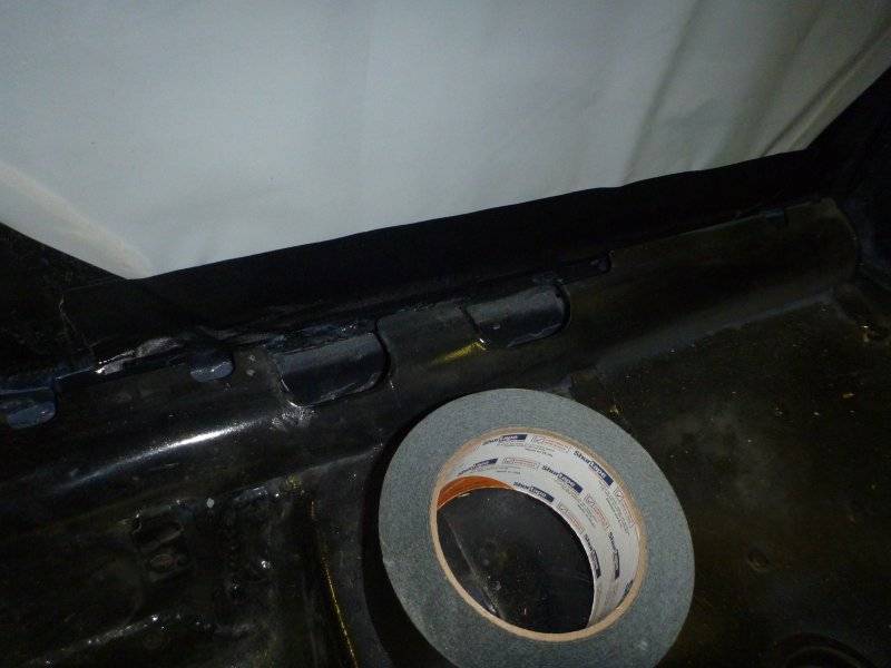

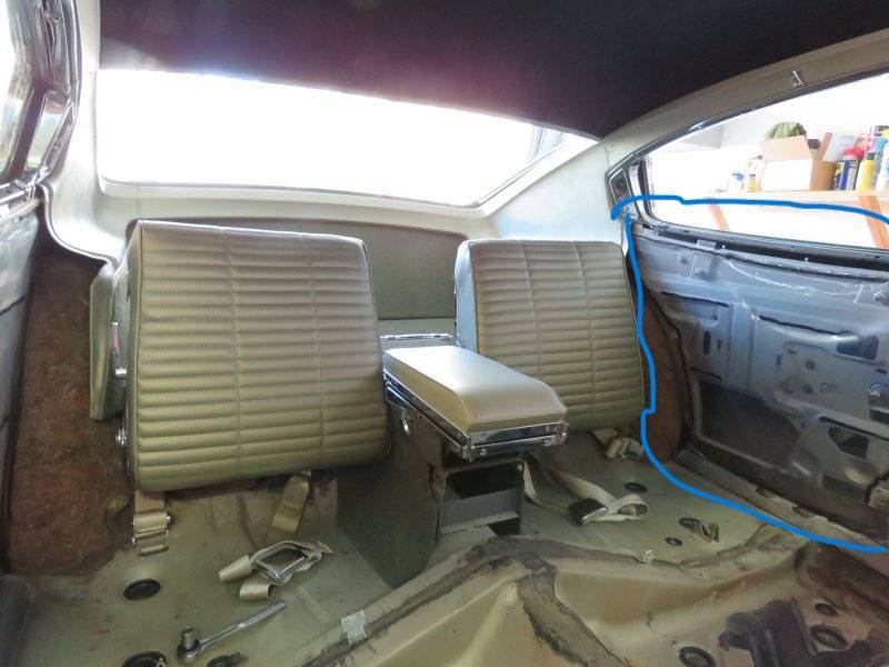

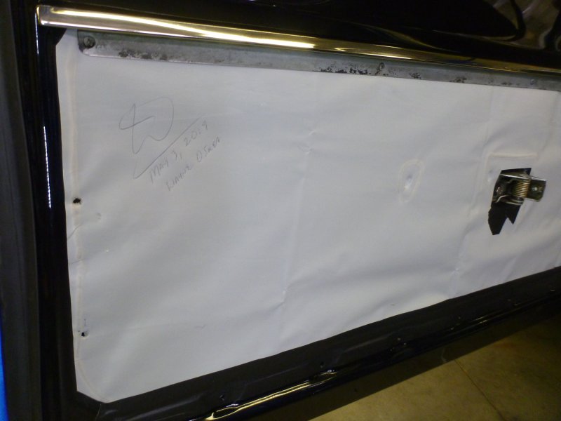

Looking to buy the plastic barrier material and black putty rope to re-assemble my quarter panels. Any suggestions appreciated.

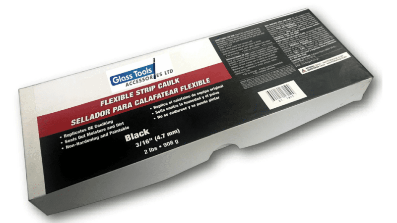

Buy mine from mega parts and 3M Strip caulk from any source.
Potential problems with "any" plastic sheeting, and mattress bags, they not UV resistant and it falls apart over time. Same with duct tape, the adhesive dries out and it falls off. Let's do repairs that will last.
I can hear the comments already, no sun behind door panel, car always in garage. This stuff is made to fail, not to last. Original Chrysler water shields don't fall apart under normal use.
I took door panels off at salvage yards and plastic bits went airborn and all over the area and inside the car, just a big mess. You wouldn't want that in your classic Looking at it it was a brown garbage bag.

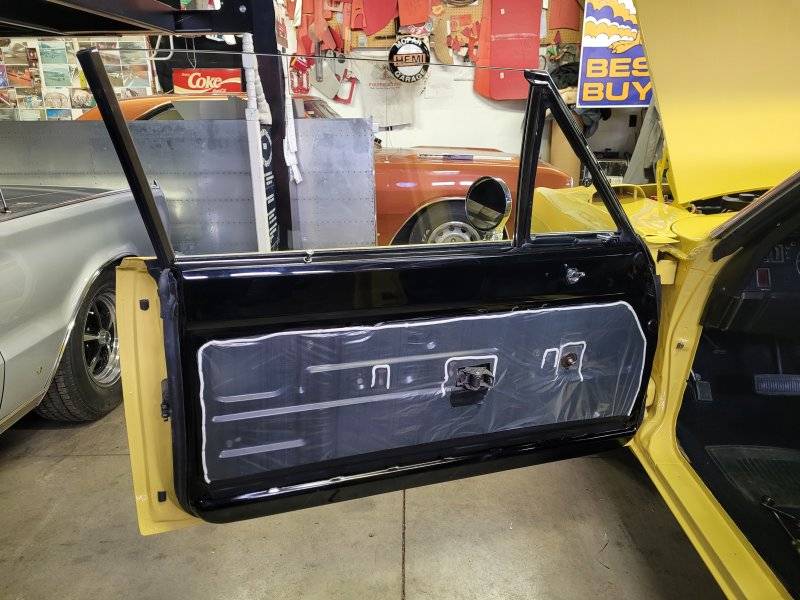

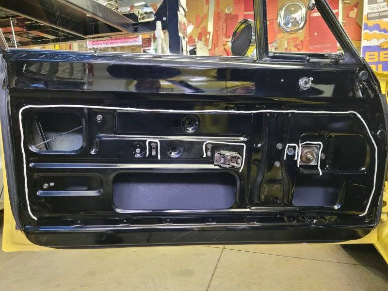

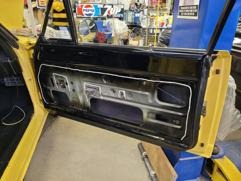

@Dean Prevolos look at the door and quarter, at the bottom of each there is a long straight line that 2" of the plastic gets tucked in to. So water doesn't run out the bottom and inside the car.
3M strip caulk works great for this.

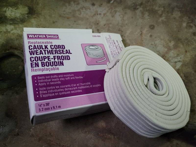

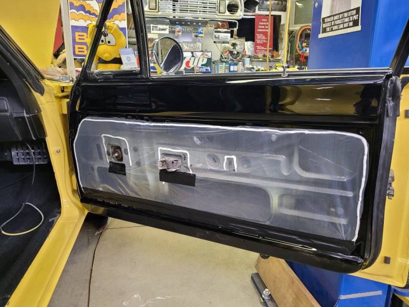

Use the good Chrysler stuff like the previous R413 stated or a good house plastic sheeting.
6 mil vapour barrier and a 4 dollar box of caulk cord / draft seal.

6 mil vapour barried and a 4 dollar box of caulk cord / draft seal.
Problem is that '4-dollar' box would cost more like a hundy down this way. :rolleyes:
I used automotive dum-dum - like plasticine, but stays pliable and is sticky, so it holds the plastic sheeting.
Yes . Don't forget to tuck.
Although I've seen it not done on virgin cars.
