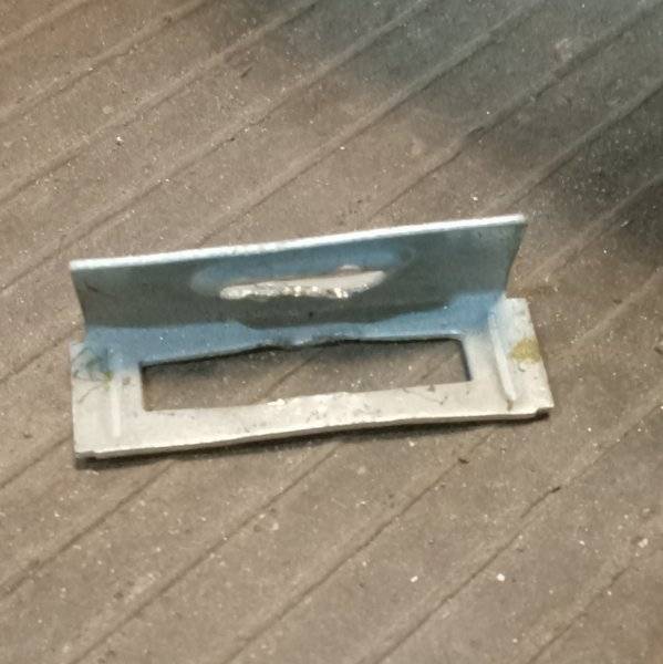

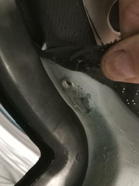

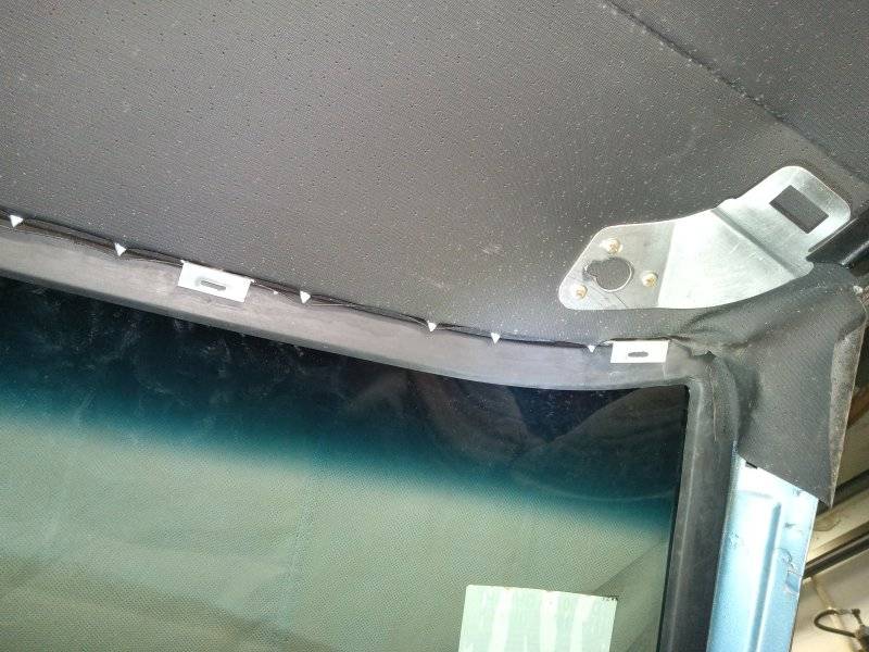

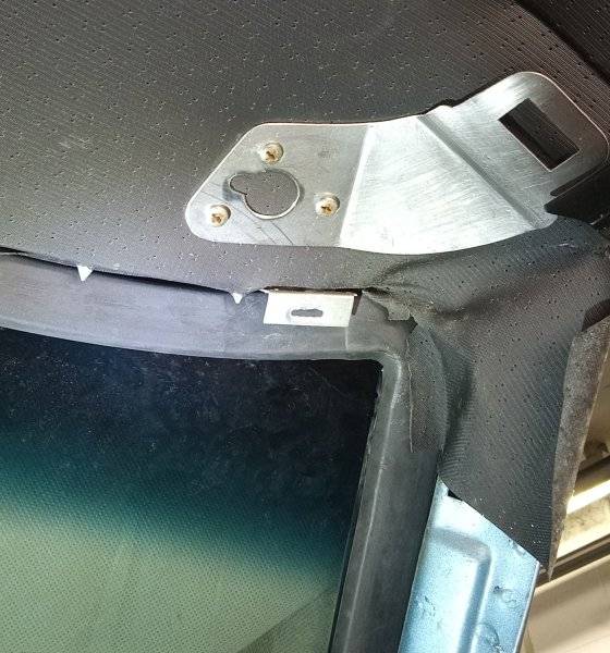

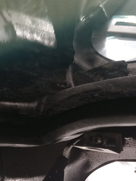

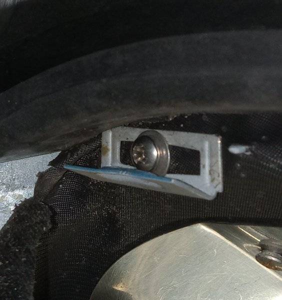

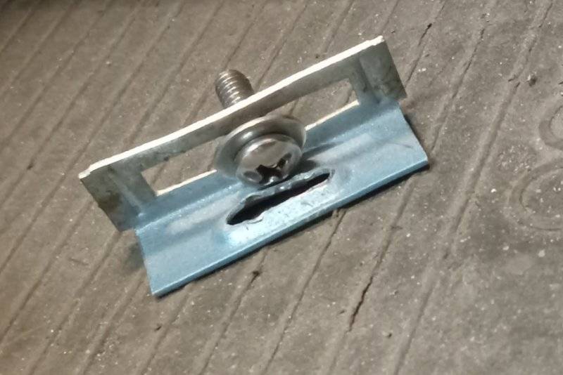

Interior upper windshield trim clip that I repaired with a 8-32 rivit-nut. I filed down one side of the rivnut so it fits the rectangular hole in the car which helps the rivnut from spinning. And installed it. Easily had enough room for the rivnut tool with the windshield and gasket in place. Using the broken oem clip I removed the rest of the tangs of the faulty clip. and with a 8-32 Phillips head screw and a thin washer just screwed the clip to the car (69-charger). I only broke one clip, and left the remaing clips alone as i screwed the trim in without any issues.
I hope this helps?
