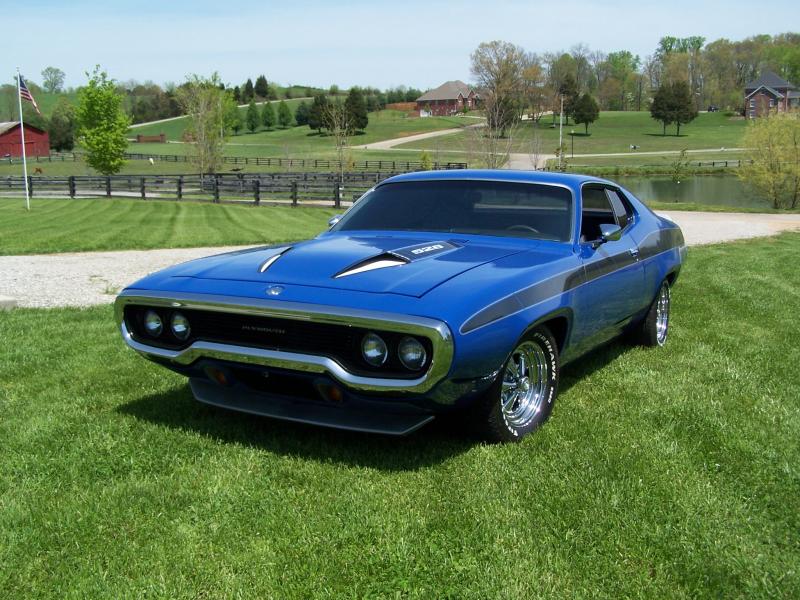

When I turn my lights on whether it is parking or headlights my temp and fuel gauges will change to higher levels. If I have a directional signal on it will stop flashing if I turn the lights to either parking or headlights. I have swapped out all my 1157 type incandescent bulbs for 1157 LED type lights. I have a 72 Plymouth Satellite.
