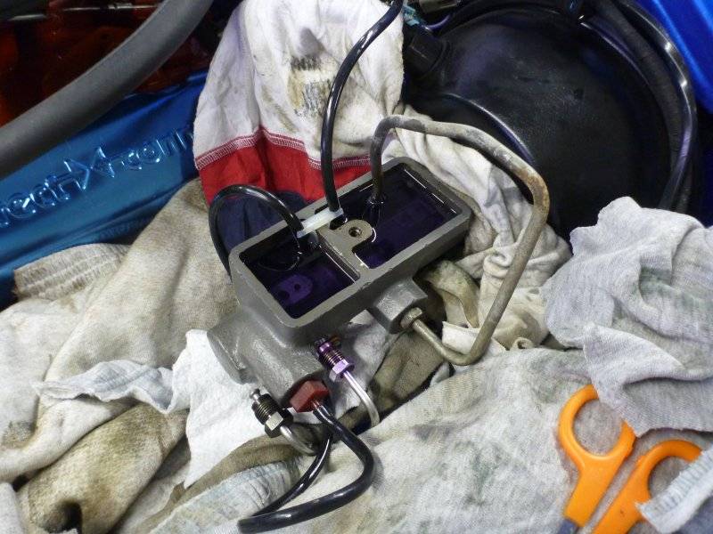

Like I showed above. Air wouldn't come out of the masters "nose" for me.Had one good bubble trapped and I had to raise the rear end to get it out..
