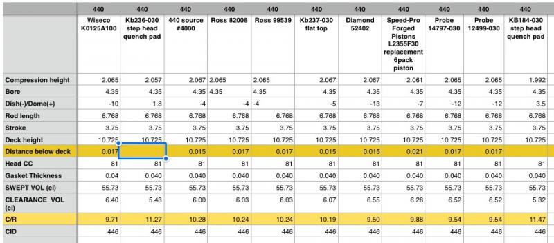

Here are the pistons I considered when planning my 440 build. Notice most pistons are designed for 0.015 to 0.017 in the hole. While planning, I made a spreadsheet to keep it all straight. Use this for your reference, but all numbers should be verified, as i easily could have made a mistake.
