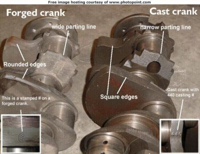

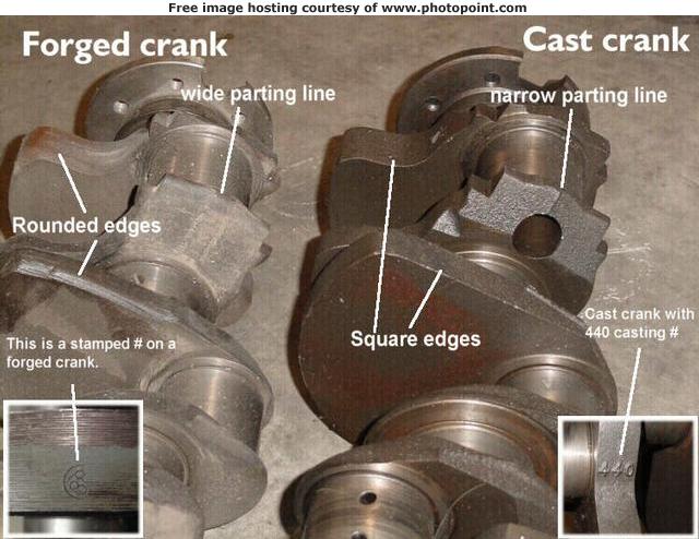

How do you id a steel crank?other than weight? Thanks
maybe this will help
