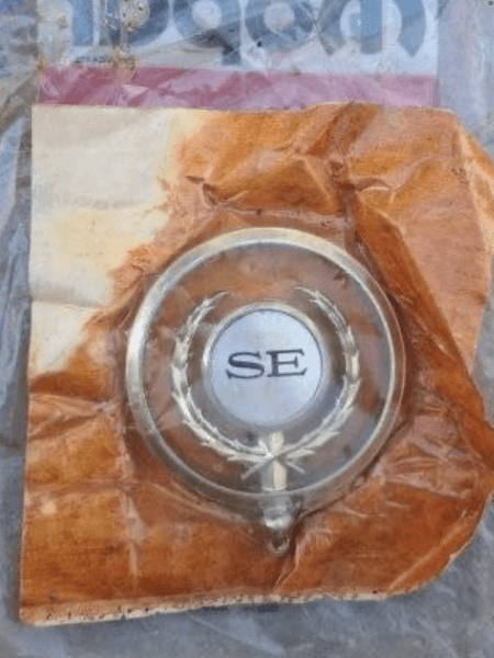

I’m looking at getting an SE next year with the opera windows and hood ornament. Is there a code, year or trim package I should be looking for other than SE? Thanks
I believe all the 73 and 74 SE's had that hood ornament.
...although I've seen examples of two slightly different styles.
...and unless it was optioned with the "halo" top, it got a 3/4 vinyl top and those opera windows.
The SE's automatically came with the hood ornament and the opera louvers
Standard on the SE, so as far I know no code for emblems. Never have known about any code for emblems on any car, just for molds.
So just looking at VIN for the WP29xxxxxxxx should be enough to know it’s an SE with its corresponding louvered quarter glass.
