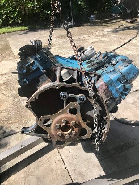

Is this 440’s crank drilled for manual trans?
Sonny
It’s all fun til the rabbit gets the gun.
6:11 AM
Jan 19, 2017
1,300
404
Florida
This is the only pic I took before installing the engine. If you zoom in you can see a hole in the crank. Is this hole for a pilot bearing? This is a ‘78 block but could have a newer crank. I heard Mopar didn’t add the hole after ‘74 or so?
Yup its a crank for either manual or automatic. But your post doesn't explain 440-4-speed cars from 67 to 70 now does it?
Sure can't see from that pic. The manual trans crank has a clearly deep two step, machined bore. The auto version is a single bore hole.
....Is this hole for a pilot bearing?....

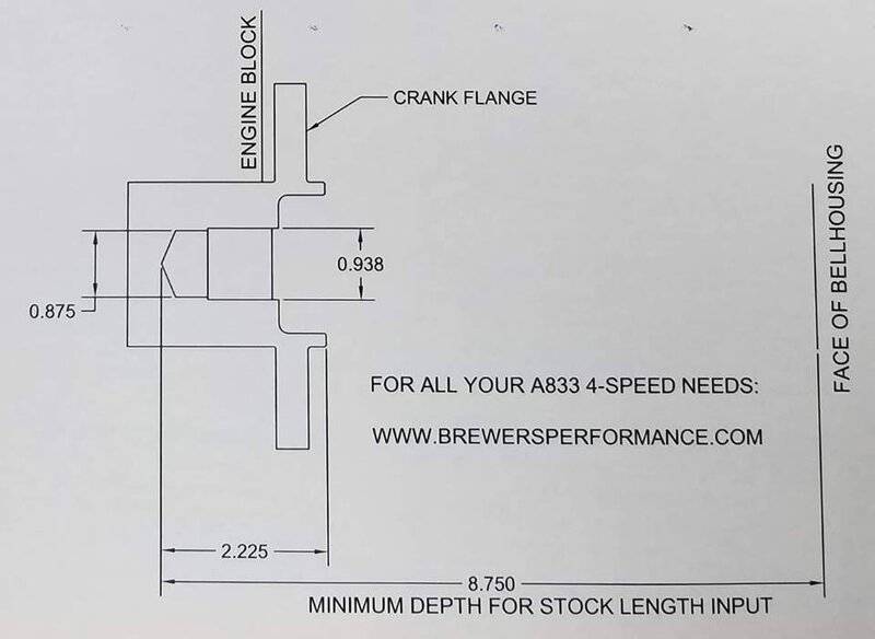

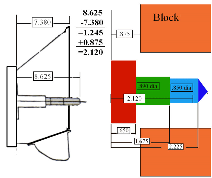

If it helps, a '68 440 automatic trans crank I found the necessary depth was there for an un-cut manual trans input shaft, but the .890" (green) diameter was undersize for the stock bushing.
A thin wall bushing, opening up the .890" diameter for a stock bushing, or installing the needle bearing in the red area of the crank are three possible options for this crank use with a manual trans.
Thanks guys. Not interested enough to pull back apart! :).
Just curious.

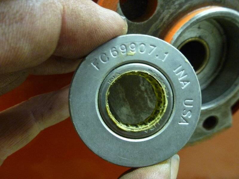

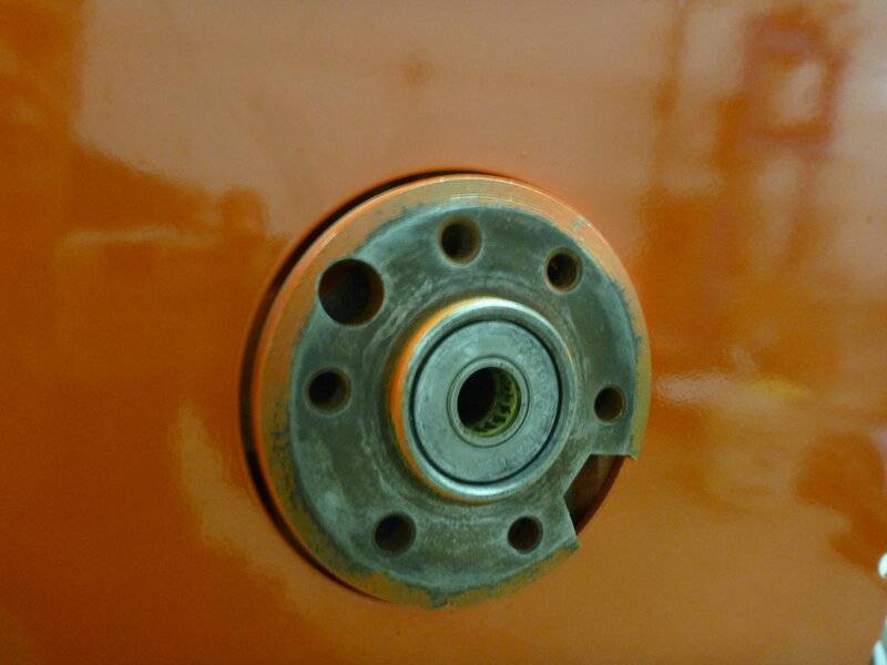

Or you can have both. Drilled crank, bushing and a bearing. Had no choice, as I'd cut the tip off my #'s trans years ago to put it in another car when I was a teen. Bearing works great and haven't had a gear grind yet putting her in gear.
View attachment 1010951 View attachment 1010952
Yup, that's the one I was thinking about in my post above. I'm thinking they are still available?
Diehard Mopar guys keep a stash of the unobtainium bushings........ :lol:
Thought maybe I still had one or two and do along with some distributor bushings and even have some brass bearing stock if there's ever a need to make one!
