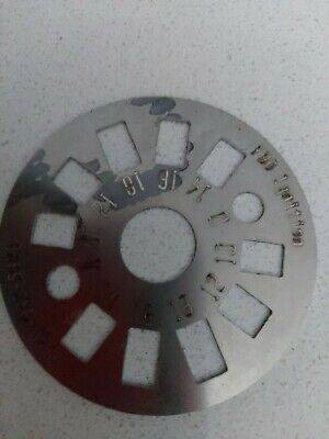

Do you have an opinion on how acurate those keys are?
Thanks RR
They are close, would not call them exact. Within a degree at least my set. Remember they are plastic also. Be nice if some one made a metal set of them. I might use them a few times a year, but it is easy for me with the machine to check it out afterwards.
Thanks for the answer. The smaller ones ( 12-14 ) just seemed to take up a lot of the
slot to my eye. Going to update to a better distributor in the near future anyway.
Thanks again. RR
Let me know when you get rid of your old one.
slot to my eye.
