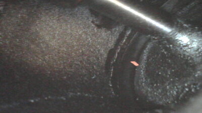

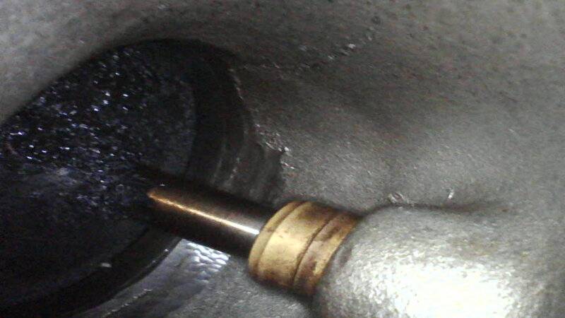

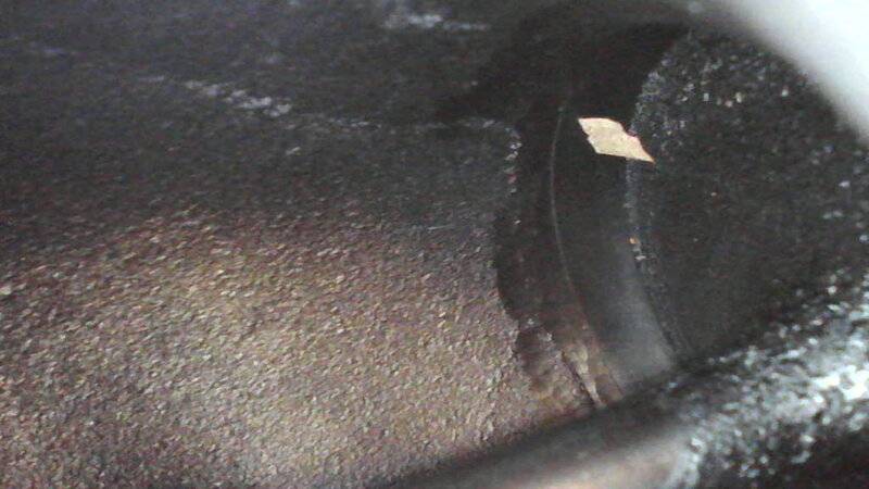

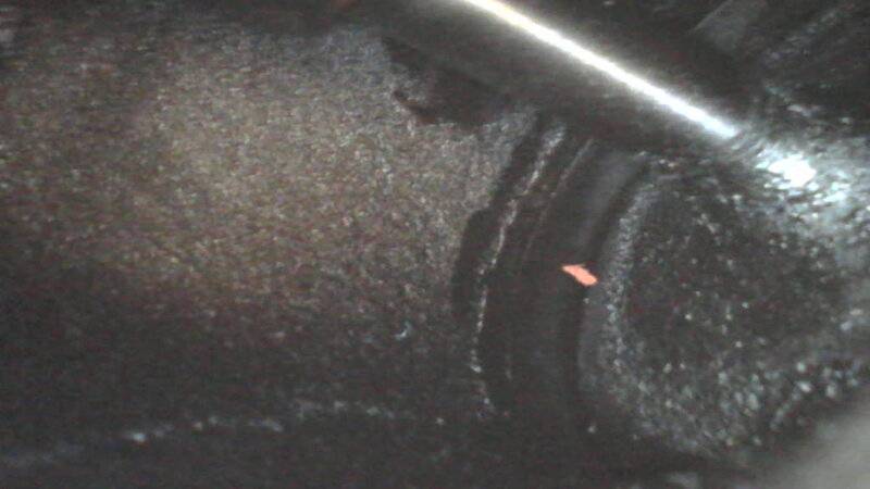

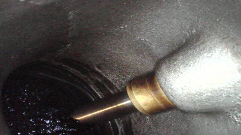

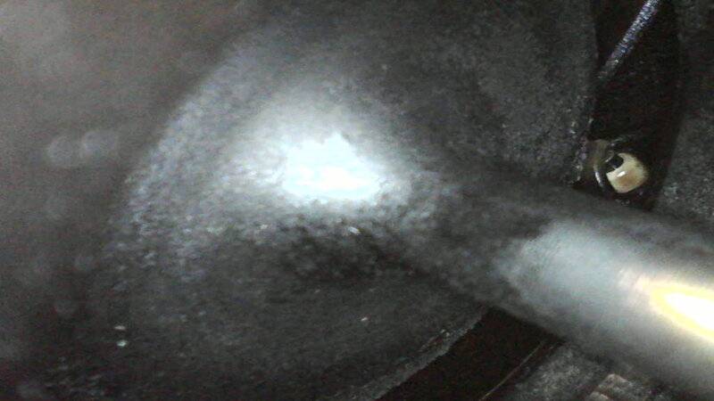

So I recently got a 70 road runner with a 383 that was rebuilt about 10 years ago. The heads are 440 source attached to a performer rpm. I bought the car with a noticeable tick but I thought it was the air cleaner hitting under the hood since it went away when just idling. I recently got a DP4B intake to get back hood clearance issues and decided I’d play with my sons scope camera after I took off the intake. This might have been a bad idea! I scoped each of the intake ports in the head an noticed that on the right front two ports as you are standing in front of the car, the intake valves have oily goo. Not carbon but fresh looking goo. The rest of the valves look fine. After staring at pics I wonder if this black line is a crack seeping oil. I’ve read about the bad batches of 440 source heads years ago. I also wanted to add that the intake was almost loose. It took no effort to loosen the bolts and all bolts were wet with oil. I included pics of a few valves that look ok. Thoughts?

Bad valve guides? If they have to come off, the machine shop can tell you.
" I also wanted to add that the intake was almost loose. It took no effort to loosen the bolts and all bolts were wet with oil"
Intake gasket not sealing allows oil to get sucked in.. Very common... You tick could be allot of things but the oil most likely is just from the intake..
That might be good news! There was oil pooling around kick down area bolts on intake. Maybe I’ll bolt up the new intake and see how it does. Thanks!

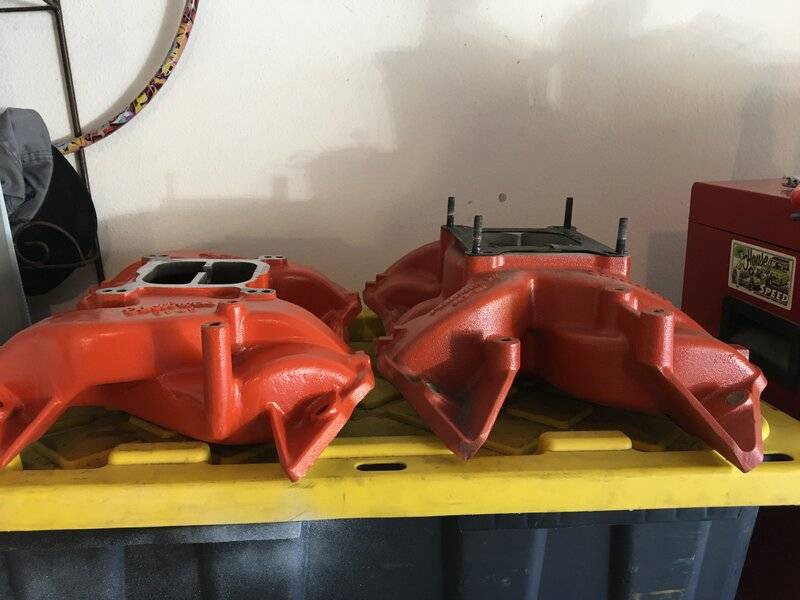

Thanks so much for the help everyone! If anyone is wondering the difference in height between a performer rpm and a dp4b (closer to stock), take a look at pic.
The oil on the valves is either the loose intake which will leak oil and collect on the valve or bad valve guides. The DP4B is a real good manifold for mild to moderate build motor and using 5500 RPM or so. Very flexible.
The tick is probably either a lifter or exhaust leak.
It could possibly be a fuel pump pushrod as well.
If the tick is louder under load (brake torque) it is most likely an exhaust leak. A stethoscope or piece of rubber hose will find it easily. If using the stethoscope pull the end out and just use the hose and ear set. Probe around next to the exhaust ports. If its leaking you will hear it with pin point accuracy. Use white Teflon thread sealer on the intake bolts. You will have no more puddles. Do not pull the heads . I doubt at this time there is a proven problem with them. Once it's running again allowing the carb to suck some water out of a pop bottle using a 1/4" hose will clean up that chamber and valves.

Looks like a casting line to me.
Oil very likely coming from leaking manifold.
Reseal manifold and forge ahead.
