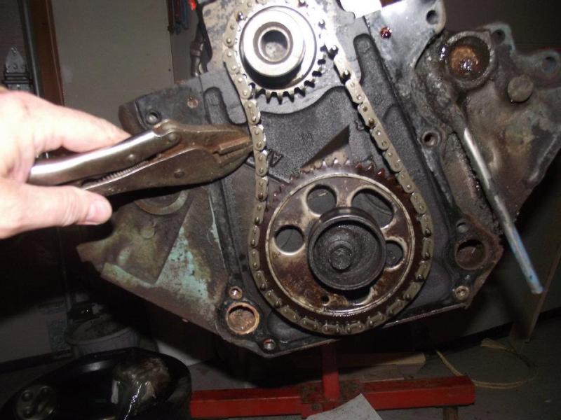

Continuing breakdown of my '74 318. LOL :headbang:
I've seen worse , but I'm sure you're gonna trash that one , Right!!
You mean the timing set? Definitely. I know now where all the little bits of plastic in the oil pan came from... didn't realize they had plastic cam sprockets in these motors...
The tensioner is plastic, and I dont see it in the pics that are provided.
No tensioner on older engines and the plastic coating on the teeth on the cam sprocket is what makes the timing chain 'silent'.......
Yup , I just took apart My 68 383 motor with what I believe to have 136k on it. Still had nylon silent cam gear in it with All the teeth. Also had original Mopar oil pump on it, Steel shim head gaskets Etc. A real time capsule.
I suppose that's one way to reduce engine noise... I don't care for the little bits of plastic sprinkled everywhere in the motor, though. The car only has about 70k miles on it.
Those plastic timing gears are horrible and are a curse upon the MoPar name! They may have been a good idea at the time to keep things quiet but after a few decades of being heat cycled/doused in oil they become brittle and break apart into a million little pieces that end up in the bottom of your oil pan and you have a handful of bent pushrods/valves. Take that crap off and install a quality double roller timing set! Back a few years ago I had a 318 with over 320,000 miles on the stock timing gear...then one night it let go luckily in my driveway. Upon teardown i could take the timing chain off without removiing anything, that was how stretched out it was!
a new timing set is definitely in my parts list for the rebuild... ever since I got the fuel pump off and saw how loose the chain was just hanging there, actually...

As far as the timing chain slack, like already said, I've seen worse. It seems that just about as soon as you start up an engine with a new timing chain set it will stretch some.
318's didn't have tensioners until the magnum series engines in the 90's and up. same for 360's and 239's. The magnums also have a roller cam and pedestal mount rockers, where the older LA engines have a flat tappet cam with rocker shafts.
