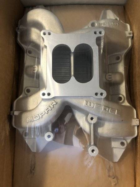

I just recieved my intake from Mancini. On the website it shows the Perforner RPM but when I opened the box, it says Mopar Wedge. They look similar? Did I get the wrong intake?

They also have Eddy RPM heads under the Mopar log except they are straight plug.
That is the intake I run as well. Love the Mopar Wedge script vs the edelbrock stuff. Same great intake just Mopar logo.

Can I use the factory intake bolts or do I need to get different ones? I will be running Source heads.
Stock bolts are fine. Remember to use sealant...The holes are still open to the lifter valley.

I have the same, on Mancini their website it indeed stated Performer RPM type.
When i opened the box i was not too surprised it is not a real Edelbrock, but these are nice copy's.
Copy? These are cast by Edelbrock for MoPar. Since MoPar wanted to “Have there own” intake to sell as there own brand, the cast in “MOPAR” & “WEDGE” are the only changes on the exterior. IF and I re stress the word “IF”, there are any internal changes, (like a port size difference) it would be at MoPars request. This is not to be confused with core shift or casting flash etc....
