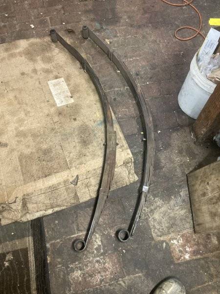

I used mopar super stock springs when I changed mine over. I did have to put in shims to change the pinion angle. (Not to get this thread banned but I’d like to get rid of the springs.)

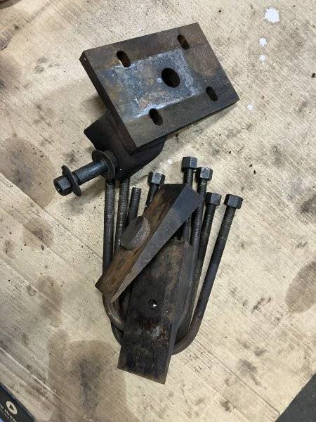

Yes between the spring and the perch. Mine was off a mile, 7 degrees IIRC.
I made my own shims, so the pins worked out. I had a broken shock mount so I also made bottom plates.

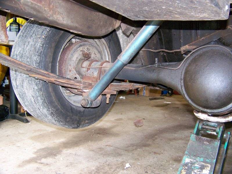

Undercar pics are from a few years ago. When I raced this setup I put old school shock extensions on.
The shocks are a plain monroe or something, probably the C-body shock mentioned in the DC manuals.
The shims I made on a CNC so I just milled the big circle on one side and drilled the hole on the other.
Usually when I make stuff I over build it.
I can't remember the year of the housing, it may have been a 71-72, so the center hole may have been different and why I had to make something special. I did all this in the late 80s.
