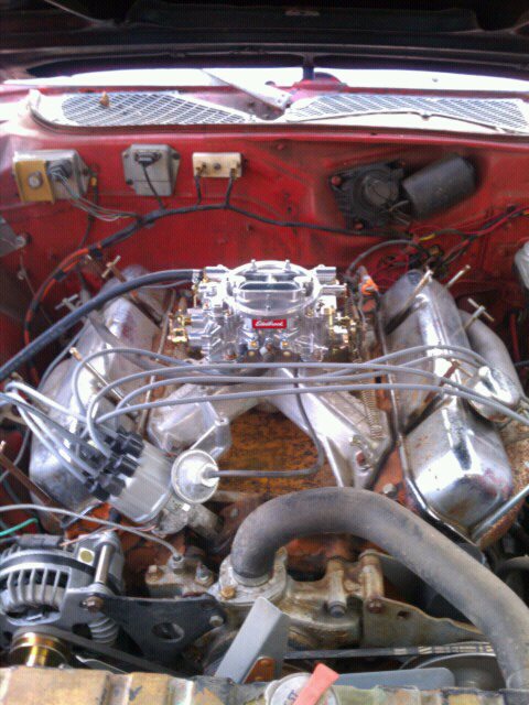

Its got manifolds on it, Its a full sized stock starter too. I havint had the chance to get back out to it today due to freak florida storms. I should of checked the negitive line on the starter, Ive had 3 V8s that shake that loose no matter how hard I tighten it, But I panicked when the rain started and I dont let it see water so I put it up quick. But about the heat issue, I dont have a shroud and its not the coolest setup, I do need to do a few more things to it to make it road trusted.
Thats whats in it so-far if that helps.

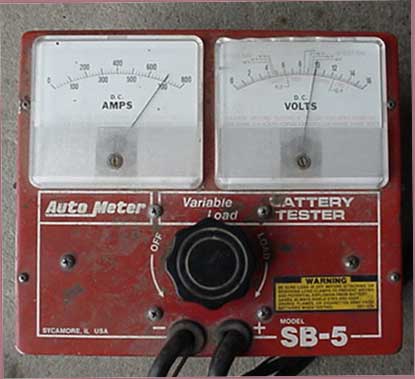

IF NOT make sure the battery is charged, or do so, then take the battery to someone who has a battery LOAD TESTER and have the battery tested
THIS is what a load tester looks like. If the teen-age "parts man" comes out with something in one hand, go somewhere else

IF YOU can get the car to wherever the load tester is, you can also use the load tester to measure starter current draw. You do this by what is called "matching amperage."
The way a carbon pile tester works is by using a huge adjustable resistor to pull current from the battery, just like hooking a whole truck load of light bulbs to it. So to test starter draw, you hook up the carbon pile tester, with the resistor to the left CCW. No load. You crank the engine a few seconds and watch for the battery voltage to load down under the sarter load, and NOTE the battery voltage with the starter cranking. Let's say, 10.7V just a figure.
Then you release the starter, and you crank in a load on the battery by cranking the resistor in CW until the voltmeter drops down to the SAME reading as when you were cranking, the 10.7V or whatever it read. Then you quickly read the ammeter and this LOAD reading will be the same as what the starter was drawing.
