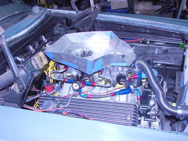

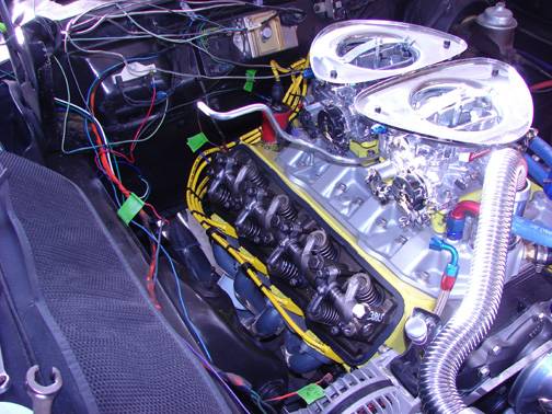

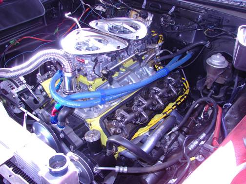

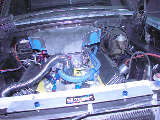

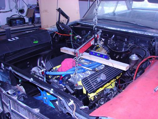

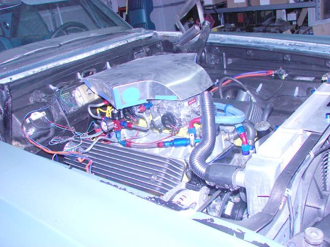

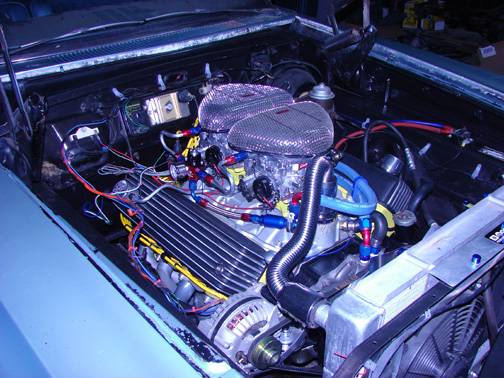

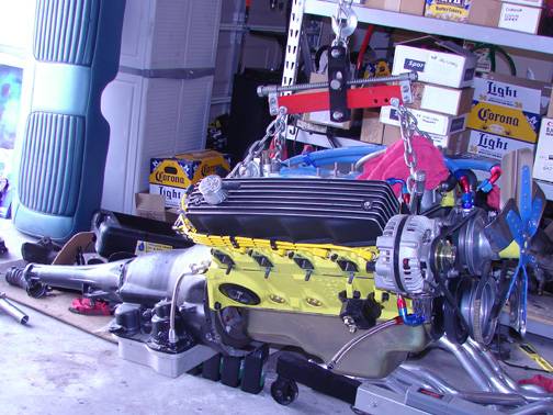

Here are a couple pics....
And installed ...
Some final checking...
And all ready to go...
So... got it installed, made all my finalizations, and tried to start it. Hmmm... seems the engine builder gave it back to me at TDC - 180º. Flip the distributor... friend dropped the dist hold-down and it took 25 minutes to find it! lol
Got it back together, adjusted the carbs a little and got it started!
But here's the bad news. There's a bad noise like something is hitting or grinding, and have no idea what it is. So it's off to my friend's shop tomorrow on a flatbed so he can figure out the problem and tune the carbs.
But I got it running at least!!! Hope the noise is something minor...
***Bigger pics here:
http://mascotgraphics.com/auto/images/polyrs03big.jpg
http://mascotgraphics.com/auto/images/polyls03big.jpg
And the custom air cleaner I built (needs to be welded). This is my first crack at metal fabrication (other than brackets!)
