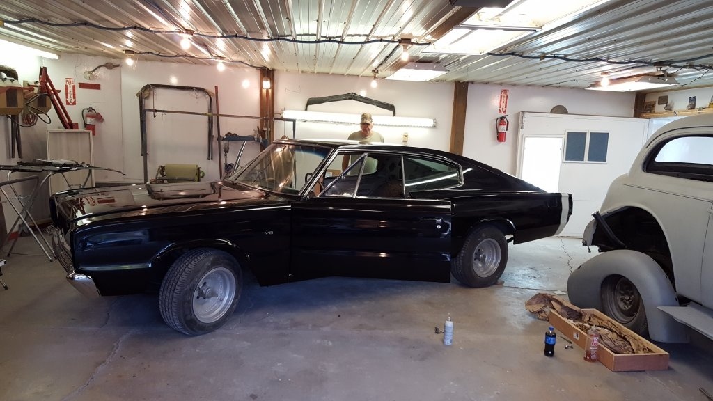

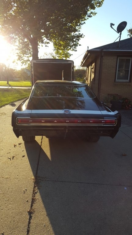

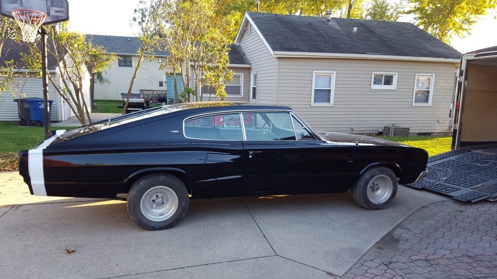

Hey all thought you would appreciate this. I bought this car when I was 14 and I just got it back from the paint shop! Cant drive her yet the interior is stripped and the engine (440) has been sitting for about 6 years I didn't have the time to go and start her every once in awhile. It's a shame I know and I wish I could take that time back but can't. I have all the interior already restored just waiting on sound deadening and carpet, then have to put the puzzle together inside... I will probably have more questions coming up when that happens haha. Here are some pics The last one is a close up so you can really see the color! I would Also like some help with the following.

Nice car.
