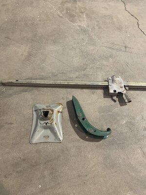

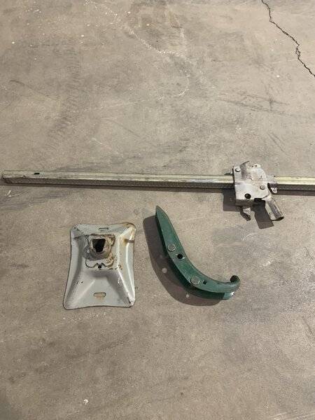

I am requiring paint codes for all the jack parts and pictures if possible
I have the 3464960 hook
Thanks
Any help on restoring this?
I can get the parts scanned but if there is codes that would be better

PlastiKote T-37 Federal Gray, Rust-oleum Dove Grey is used on the mechanism and base or you can buy from a Mopar restoration place. Most use John Deere green for the hook it's close but not exact.. The mast is plated.
There's also a rectangular sticker on the jack base that says Caution Follow Jacking Instructions. Year One has them for $10

I can tell hook is definitely not john Deere green so will try to scan it first

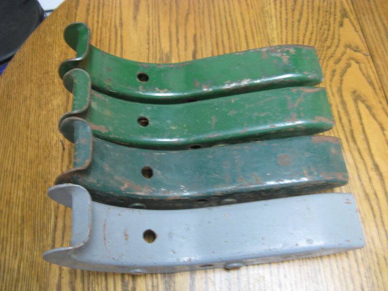

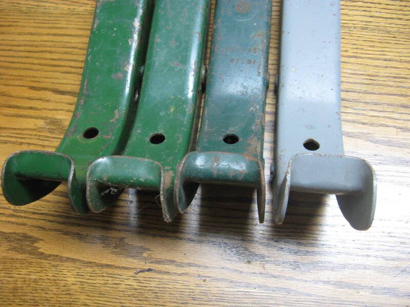

They fade a lot and again it's what most use since it's close and easily available. You can see these old 71 RR hooks I have all wearing original paint the different shades. The biggest difference is the 3rd green hook it's a Canadian hook and has a different color than most. The first 2 match JD green pretty well. Even have a pic of my older JD for comparing color..

I used JD green on mine as well.
John Deere green was no where close to my original color. Rustoleum hunter green was almost a dead match for mine.
