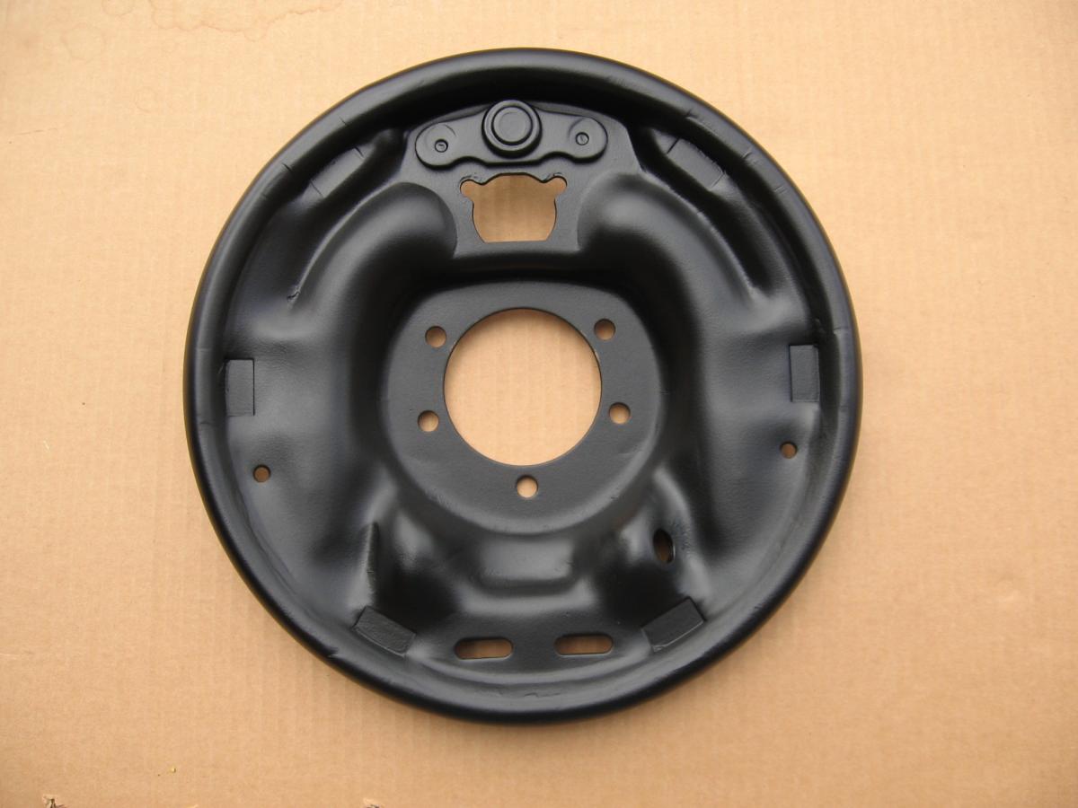

I picked up on this tip on a Jeep forum. It’s no DP90, but as rattle can paint goes John Deere blitz black is fairly tough and has a nice semi gloss finish. It’s also available in quarts….requires a special thinner.
