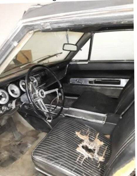

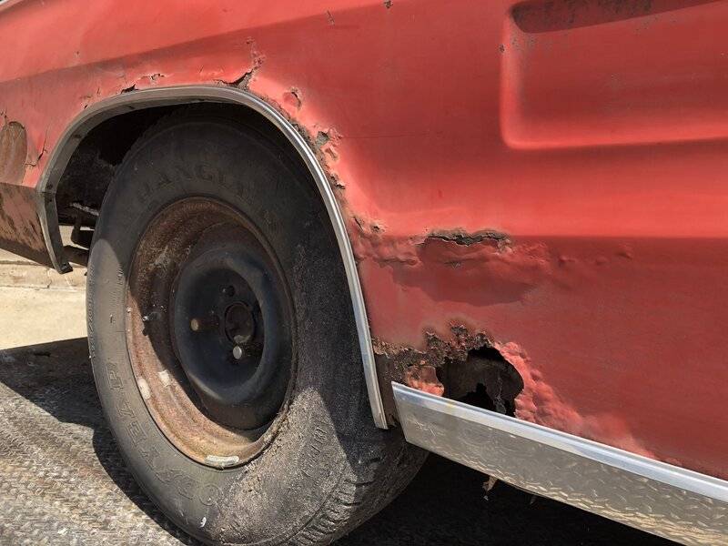

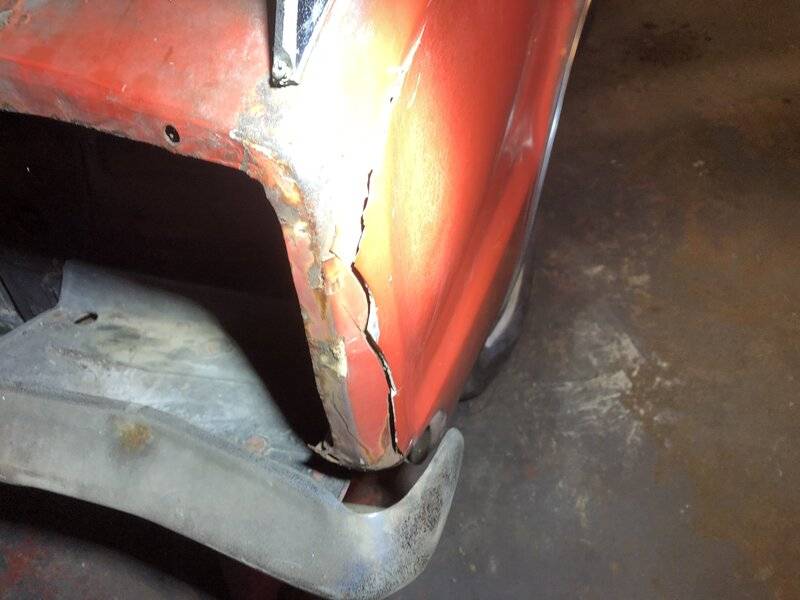

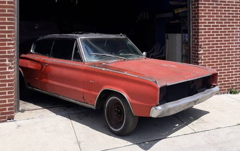

Hey there! So just bought a rusty, rotten, but affordable 67 charger. 318, automatic trans, I’m clueless. This year charger though has been one of my dream/holy grail cars. But I ain’t made of money. Never thought I’d be able to afford one. I love watching Roadkill, Vise Grip Garage and other channels on YouTube and they have given me more confidence about working on cars mechanically. And they make driving junk cool and I’m cool with this being a rat rod. But I could use some web sites, links, tutorials, how to videos and anything to get this pile running and driving.

Congrats on the new charger! Make a list of all the work you need to do and then do one small project at a time. Focus on getting it running, driving and stopping safely first, and any major structural rust patched up and made as safe as possible then start enjoying your car....the cosmetics can come later as you have time and finances to support it.

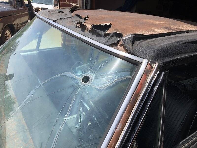

I just hope that bullet hole in the windshield wasn't the cause of the previous owners demise.

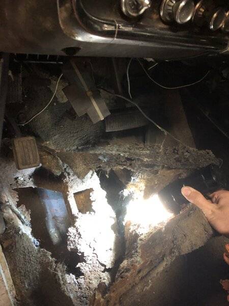

Before you do anything with that you really need to take a close look at the torsion bar cross member and frame rails.
Take an awl or small phillips screwdriver and pop it into any areas with crusty rust or bulged out areas.
You need to make sure it's structurally sound, then brakes, engine etc...

From what I can see, it's not rusted beyond repair but it does look like a handful.

As others mentioned. The first money you should put into it are to repair safety/structural items so it will pass safety inspection.
brakes, suspension/steering, frame are the big 3.
Probably around $1000-1500 in parts depending on what it needs.
