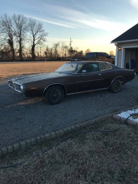

I recently picked up a 1974 Dodge Charger SE at a great price for the condition it is in.
A little back story on it: This car was originally bought in 1974 and then was in a fender bender in 1976. Another guy bought it in 1976 and replaced front bumper and has had it ever since. In the late 1990s the car was parked in a concrete floor metal building and has sat there since i purchased it on January 26, 2019.

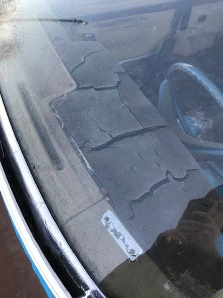

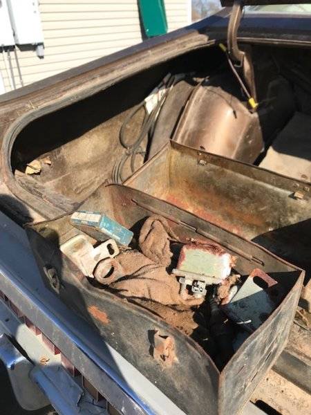

Gotta have the essentials, notice all the belts? also sparkplugs and various other things in the rust box

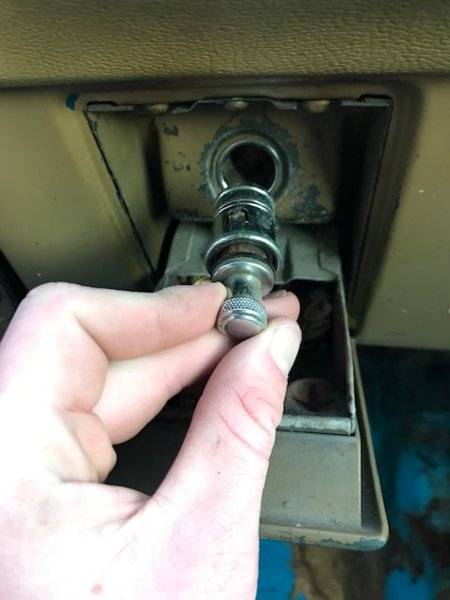

Not sure what this button does... it comes out of the dash!
Joking....

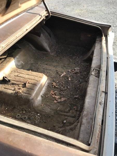

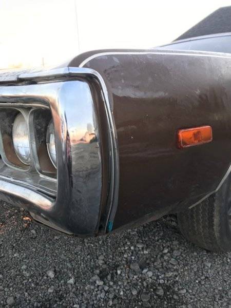

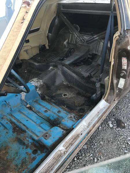

Seems pretty solid, as long as it is not raining this weekend i may try to get some better pictures of what will need to be addressed. seems like only one quarter panel and maybe the truck need to be actually replaced rest may be able to be patched. Probably will just get the new panels instead of patching.. not sure yet. I would like to do it right the first time to have zero issues later with rust.

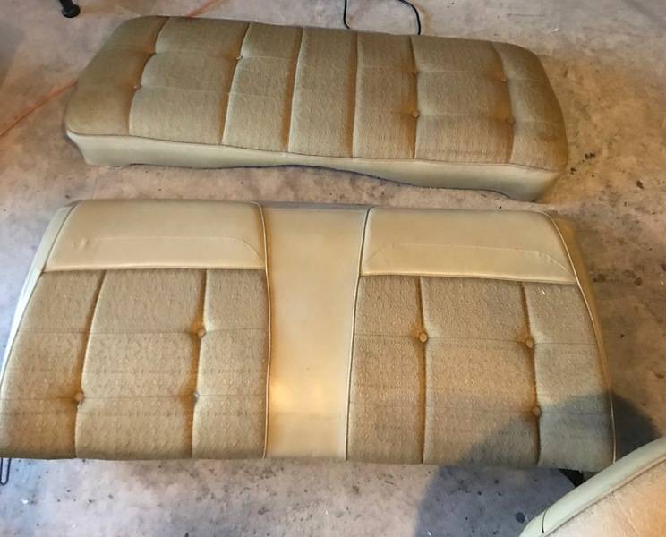

Seats seem decent for the age but will be recovered
These also were in the back seat.. not sure what they are worth would need some cleaning up.. anyone interested just let me know.

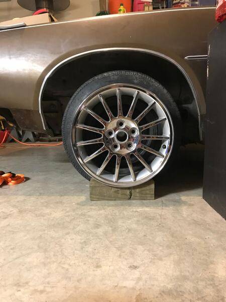

My wife and I were at a pull a part yard looking for something and ran across these. She said they would look good on the car..
shined up..
bought them and turns out the lug bolt size and pattern are the same but wont fit due to the hub/dust cap. shown here

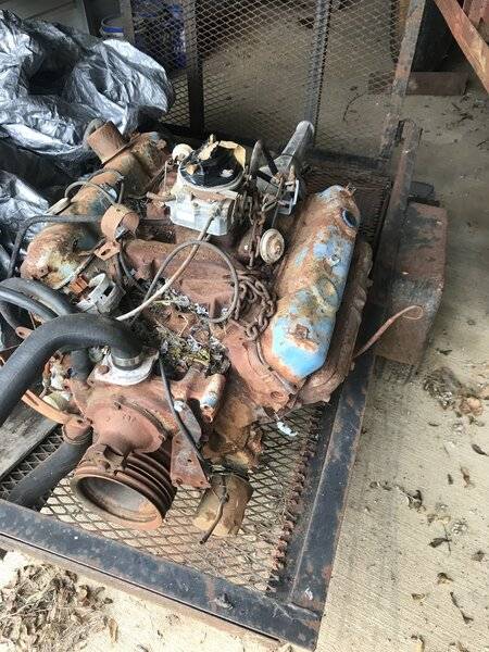

Thought you all would like to see a dirty looking junk engine that I picked up to rebuild.
I need to check the casting numbers on it to make sure, but it should be a 400.
