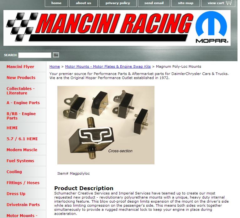

this is probably over kill for Jacob's truck but anyone have anything good / bad to say about these? Could they cause failure elsewhere by taking flex out at the mounting point?
http://chucker54.stores.yahoo.net/newmapopomom.html
I've 'jumped' plenty of vehicles in my 46+ years of driving and don't recall breaking any motor mounts but I suppose it's possible depending what exactly you did to it. And getting 1 foot off the ground is nothing! :D If it's the driver's side and the rubber isn't oil soaked and has good to hell, I'd chain it down but if you're trying to keep things 'right', then I'd go with one from Mancini or from someone who sells those kinds of mounts. I know Dodge trucks (but not Dakotas for some dumb reason) started using interlocking mounts a long time ago so even if the rubber does break, you're not going to do damage to anything else.

Jacob, you need to be more clear in your posts. Your original post clearly asks WHERE to get mounts, not what the best type is. Really in the aftermarket, they are all about the same. Anchor chinkesium crap. Unless you want to step up to something like what was posted above in the Mancini ad, that's pretty much what you're limited to. I'm going to use cheap mounts and make an adjustable torque strap for the driver's side out of a heavy duty turnbuckle. Probably kess than 20 bucks from our local Ace hardware.
