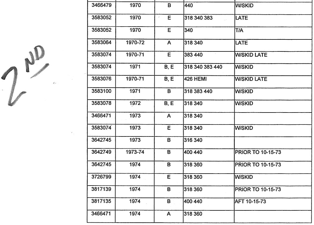

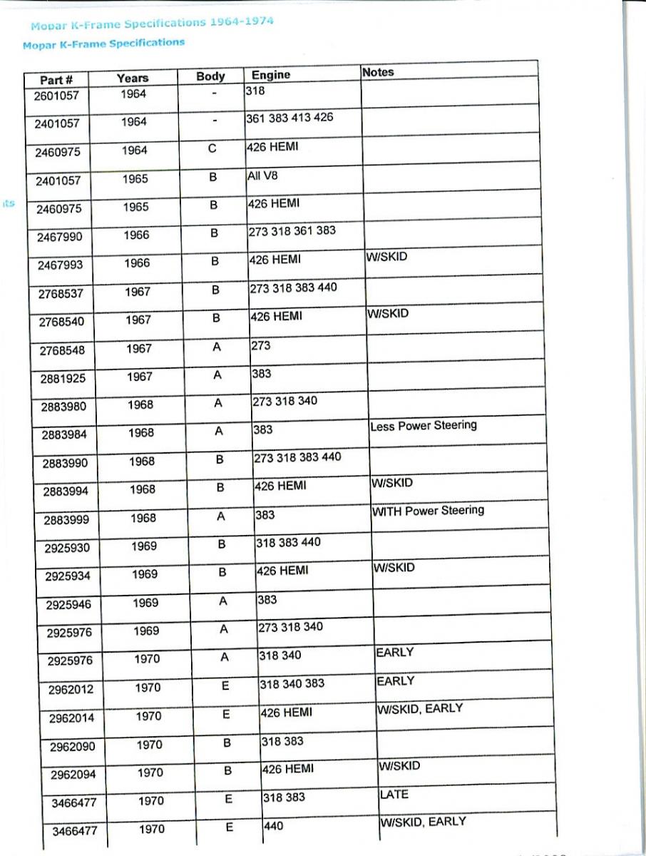

Here is a list of K-members by part number and year. There is quite a few that fit, The big difference is where it moves the engine to. ( forward or back )
The 70 cars have a different sway bar location but otherwise will work. If you want to keep it original I'd stick to a 68-69 model.
Great K member P/N list!
Perfect timing, I just picked up a 66 Belvedere II with a Poly 318 and wondered if the K member would work with my 440, my car has a Hemi K member in it! Thanks...great info
