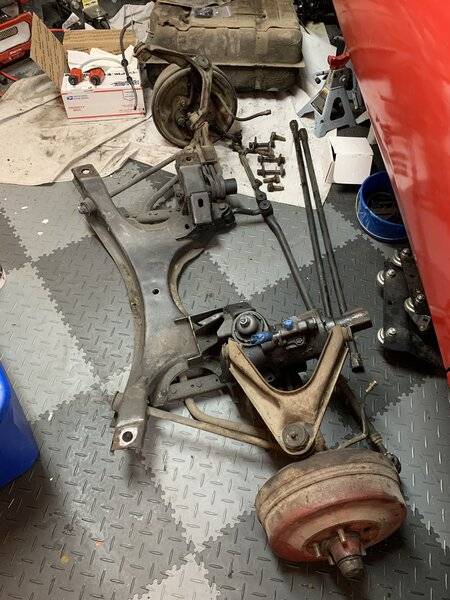

K-member, steering box, front suspension out, and I’m proud of it! All by myself! Now, disassembly and buying new parts! PST, Moog?

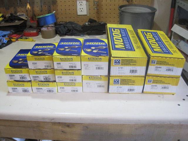

i replaced my lower ball joints with moog problem solvers up dated the tie rods to 11/16s firm feel from the stock 9/16s and the tubular upper control arms with the 5 degree pos caster very good dont forget a good alinement
Moog for joints, energy suspension for rubber goods, PST squeak and the boots for joints are kind a hard and crack.. lifetime warranty my butt! On the moog stuff make sure it’s made in USA.

If you're sticking with stock, go Moog for all replacement parts.

I agree with he guys, moog for joints and energy suspension for the other, i buy the entire suspension kit from energy, instructions included

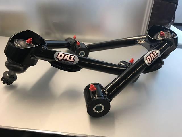

Using Pro Forged for the joints and QA1 for the control arms on mine. The Pro Forged parts look pretty nice.
