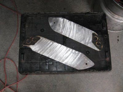

And if you're racing it, there's nothing like moving the engine/trans back for better weight bias. Even one inch makes a noticeable difference.
Oid racer trick works well, may have right rear cyl head and heaterbox/firewall closeness but all okay.
