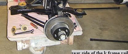

also what keeps the K frame from moving around ? the original bushings had a square metal box that fit firm into the holes of the frame the replacement ones do not look to be as well made . here is a pick of a 73-74 K frame

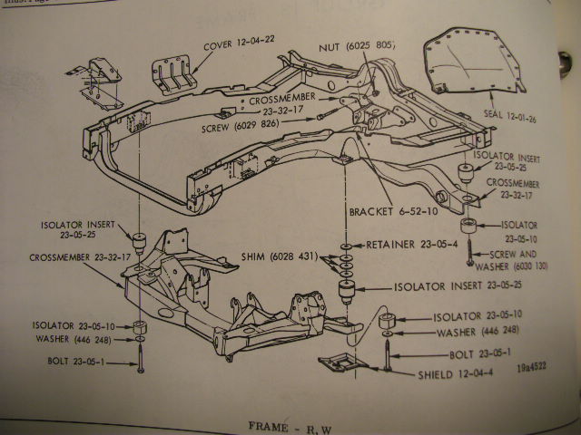

Don't know what to tell ya, put here is a pic from 74 RR from Chryler dealer parts catalog that might come in handy for you, also e you about pics of alt brackets on 74 RR/GTX, did you ever find Brackets?

My personal opinion, get the solid bushings from Firmfeel. It's a high quality kit. I think the bands you are refering to were only to hold the shims to the mounts at the factory during assembly.

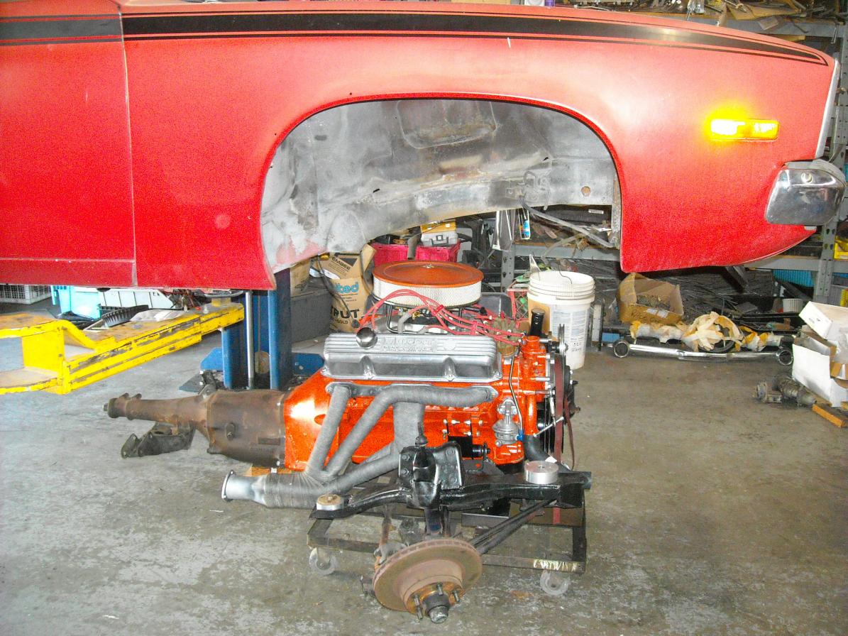

A friend back east made mine for me. Solid aluminum. It really helped stiffen the nose on my bird.
Yes you can. There is a thread here about someone putting poly bushings in with the K still installed. I was doing the big block/4speed swap on mine at the time.
