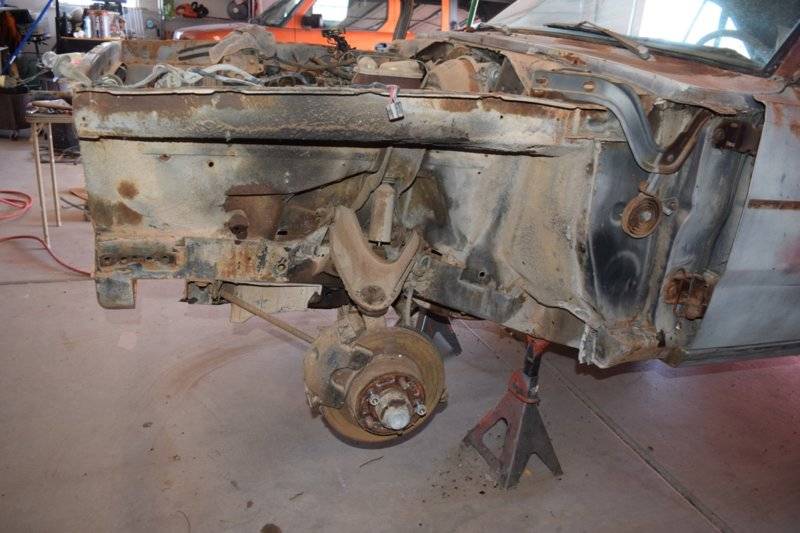

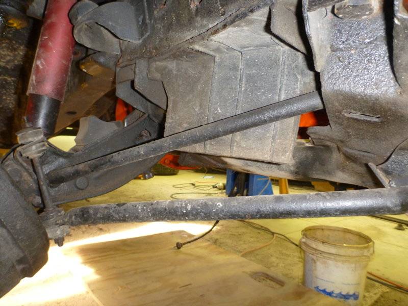

Does anyone have instructions for where the K member splash shields mount? I went nuts two months ago ordering all kinds of crap from Classic and found these in the pile...but no idea of how or where they mount? I checked with Classic ind. web site but found no offering of instructions. Included in the box with shields is rivets for drilling holes which make me think this is an after market idea for modifying protection from rocks and gravel. Any pictures or a lead on where to get help is appreciated.
Factory, most were riveted but some got self tap screws. Holes should be in the rails.
