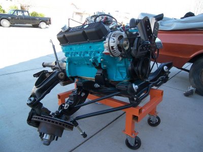

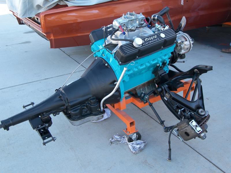

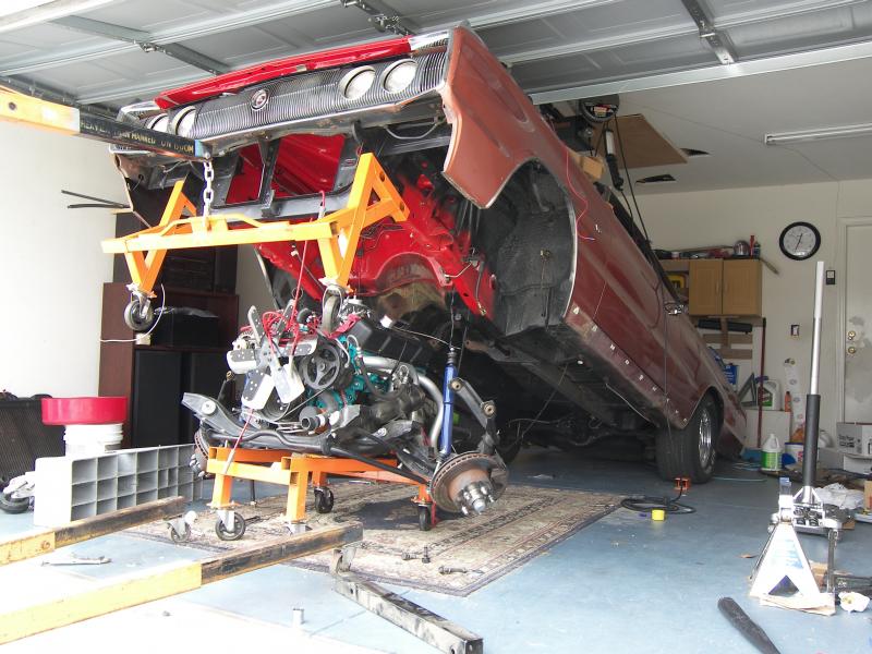

Pics of my 67 charger when i did the swap, i believe i just disconnected the upper control arm, pulled the torsion bars,drive shaft, then unbolted K~member and trans bolts, it really was easy with a kit that i bought from Dutch brothers
