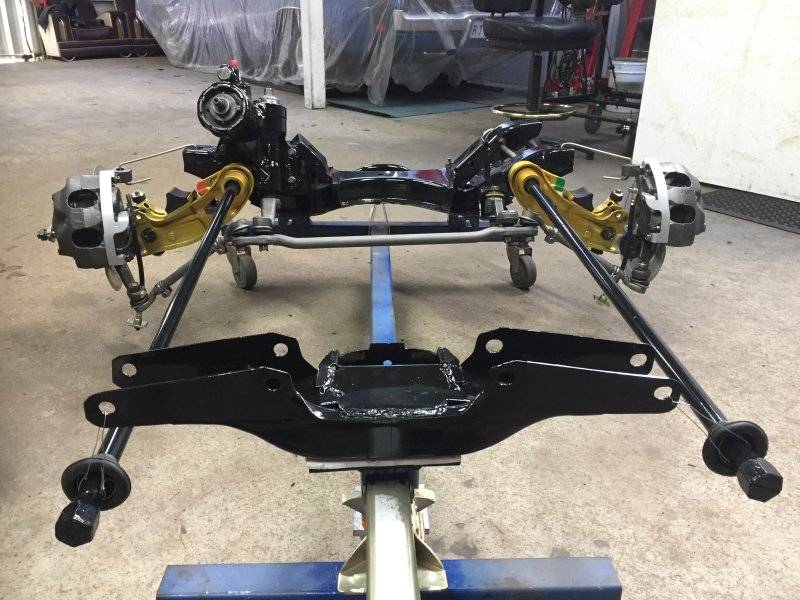

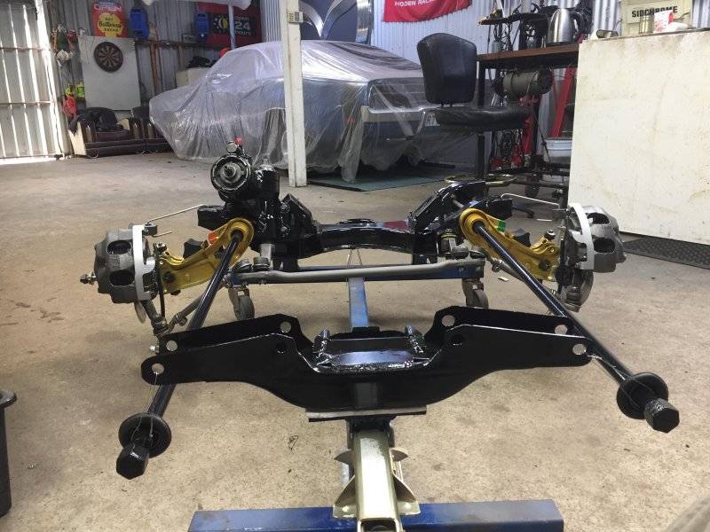

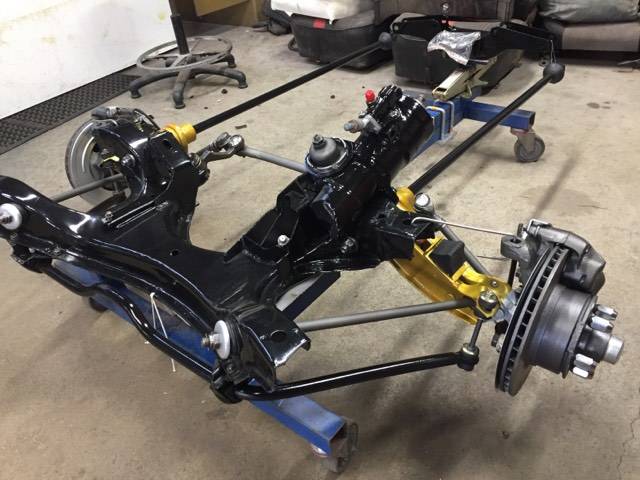

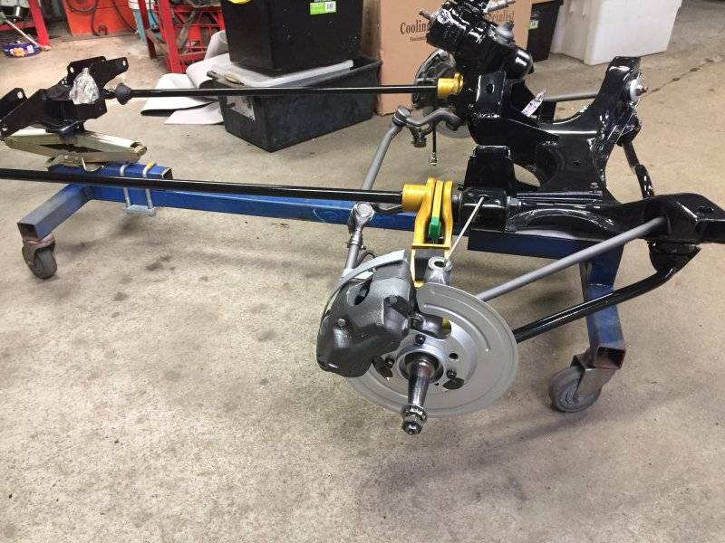

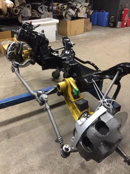

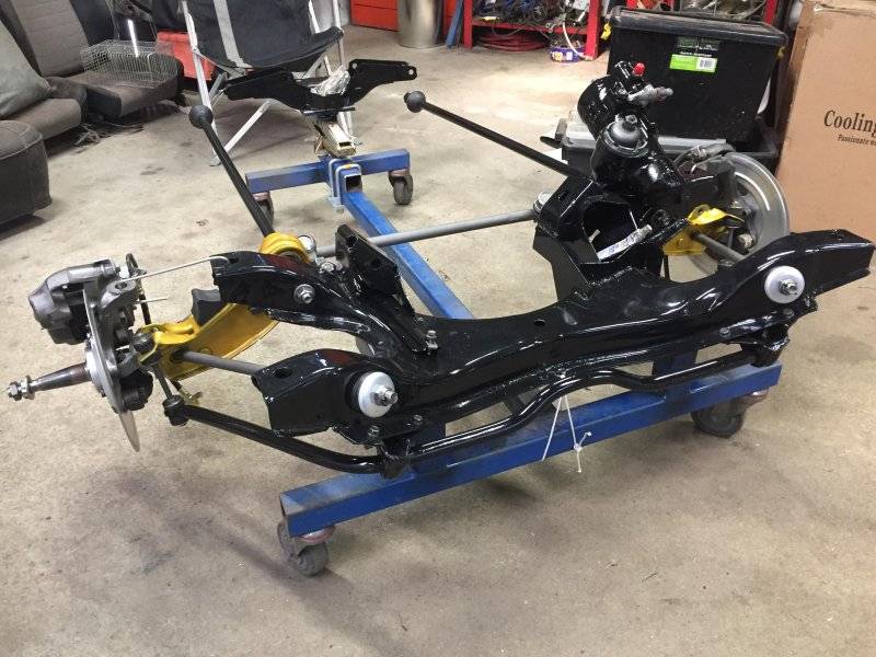

Been working on the K Member lately everything is painted and started assembling all the Nos ball joints upper & lower ,tie rod ends, idler arm,pitman arm new brake caliper kit new control arm bushes upper & lower strut rod bushes ,sway bar bushes, new brake hoses,wheel bearings and dust caps, power steering pump i'm very happy with the result considering i done it all myself and a first timer

Hello i'm sure yours will turn out just as good if not better. I 2pac painted everything even the raw steel stuff is 2pk i had a special paint mixed to replicated raw metal.The nos parts were mostly found on evil bay or on this and dc forums but if you can't find nos mopar the older TRW stuff is probably just as good quality as i seem to remember reading somewhere TRW made the Mopar stuff anyway back in the day.I just found the correct idler arm as i have the incorrect one on K frame at the moment. As to the dipping no these were painted in 2pk paint too replicate the original dipping including the dripping affect. The pivot shafts were cleaned out and masked off so no paint would go in & i added a tiny amount of no cease paste in the shaft holes & also on the tie rod end tubes prior to assembling.Good luck with your project
