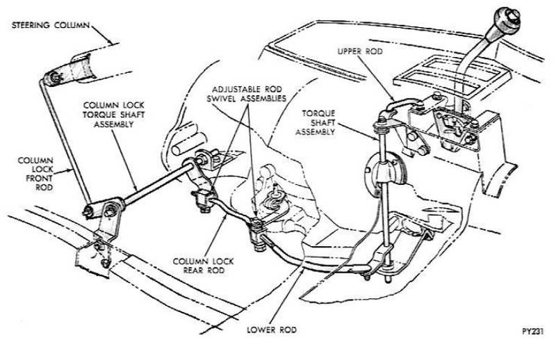

1970 charger with a 383 and 727. Center console shifter. I’ve read so far about the “reverse lockout” where the key only comes out in reverse, and I’ve read about issues related to the linkage but my linkage seems to be ok? I’ve tried pushing the shifter in different directions while in each gear and trying to get the key out but it’s sill stuck in the “run” position. Like any other vehicle would be if you were in gear and tried to take the key out. I’ve got a manual but I just want to see if there’s any tips or things to look for that you guys could share with me. Thanks

Grab the lower column collar in front of the instrument cluster and twist it CCW while in Park and if it turns you'll get your key out and you need to adjust your "lock out" linkage.

Key is on the column yes, but the steering wheel is not locked in place (like on all my 80's chevy pickups). I have done the jiggle steering wheel back and forth trick many times on older vehicles and it works, but not this time. I tried rotating the collar, that didnt work. Looking in the manual now for any info on the lockout linkage.
Looks like I'll be messing with this later today !
Just pull the cotter pin on the link to the column "arm". Then try turning the collar as I noted earlier. Then you'll know if it's the linkage throw or the key mechanism itself !

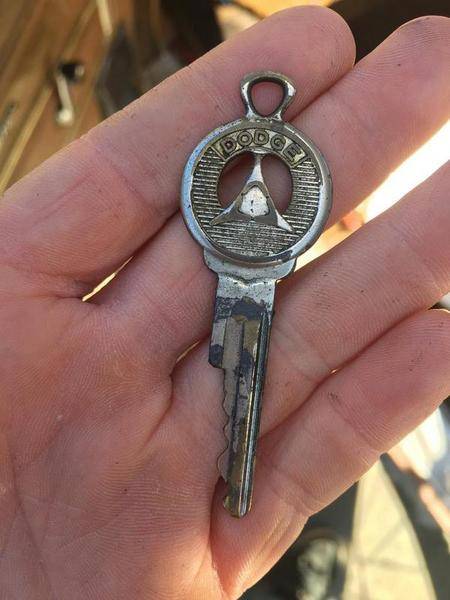

Yeah I don't know how it's a round key... it works for the ignition and the passenger door... driver's side just might need some WD-40. Having a trunk key made tomorrow AM... it'll be the first time opening the trunk since I've had the car.......
Hope I didn't sound harsh. Up until a couple years ago I had the original keys from my Charger that were fairly unused. They were perfect.
Somehow they got lost on the driveway, I think it was putting the car in the barn for the winter. Didn't find them for a couple years, they were usable but worn and weathered. That was always one of the cool little things about my car, but like many things I messed it up.
I suggested the lube earlier because about 5 years ago at Carlisle one day my trunk lock gave me trouble after working perfectly for 25 years.
On a whim I put some motor oil on the key stuck it in and out a few times, locked and unlocked it a few times and it's smooth as silk once again. So apparently a little oil every 49 years is the minimum service interval.
