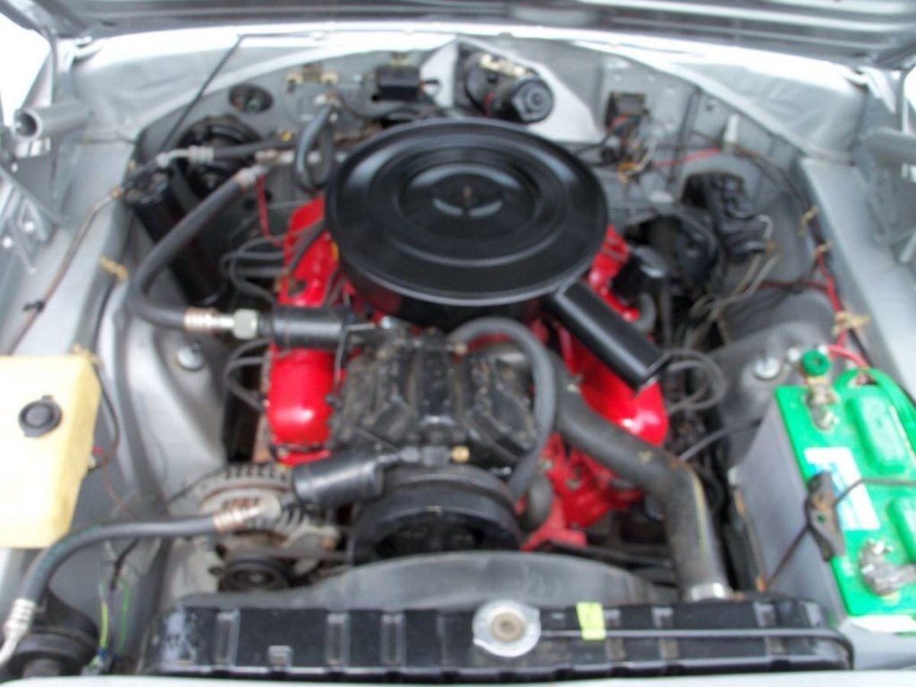

Well my 318 started to knock and once again I was facing an oncoming Summer of missing out on cruises, car shows, and racing. My planned slow conversion from show pony to street/strip monster had taken a frantic leap forward leaving my meager toy budget in a state of crisis.

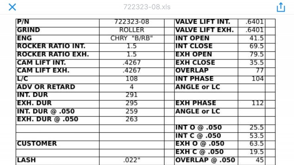

So here are the details: sonic checked 400 bored .035 over, 440 source 512 stroker kit, stealth heads, estimated 10.5 compression ratio, tunnel ram intake with twin Predator carbs (my uncle ran them on his jet boat back in the day) and a custom grind Howard's Roller cam:
SOOOOOOOO,
What kind of hp do you think it will make? I will probably switch to a single plane intake. This won't see much daily use. My reasoning is the short block and heads alone are worth as much as I spent.
That sounds like you were in the right place at the right time. You will have to locate a big block transmission case and have the internals swapped out at minimum. Maybe you will luck out again and find a built transmission too. I'm sure that the engine will make good power with a single plane intake but I couldn't tell you how much. Someone will chime in I'm sure. Good luck with your project.

I'm also going to rebuild my 318 myself to gain some skills. I've done bolt on stuff but never anything that big. My friend from work Victor built a hobby shop. He rebuilds WRXs and has a couple S2000s.
