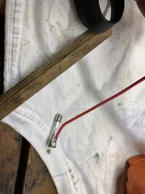

I had a hell of a time finding a key on source when I installed my stereo also. I ended up doing this...
after I did it and was finished I found out later they make a terminal tab that you can connect to the end of the fuse while it is in the fuse box.

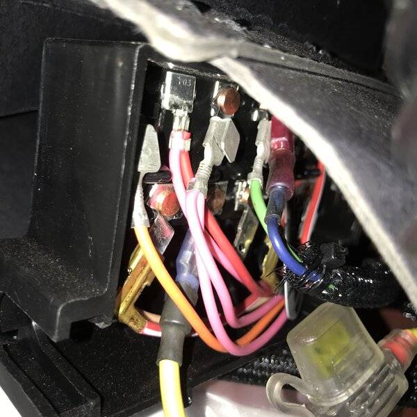

Saw This For a Keyed Ignition? Spare Post On The Pink Wires. Wondering If Its Okay To Use?
Check it for 12V. with key off. If nothing, check it again with key on.
View attachment 1254500 Saw This For a Keyed Ignition? Spare Post On The Pink Wires. Wondering If Its Okay To Use?
Yes, that’s what the factory did to connect accessory harnesses. My 66 Satellite has up to two of those a back of single fuse box terminal for accessories. Need to verify that fuse is for a key on function.
