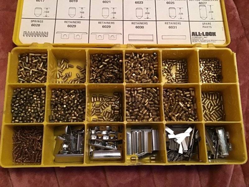

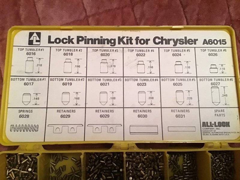

I see no way, without pulling the locks on the doors. Then the locks can be made to fit your key.
