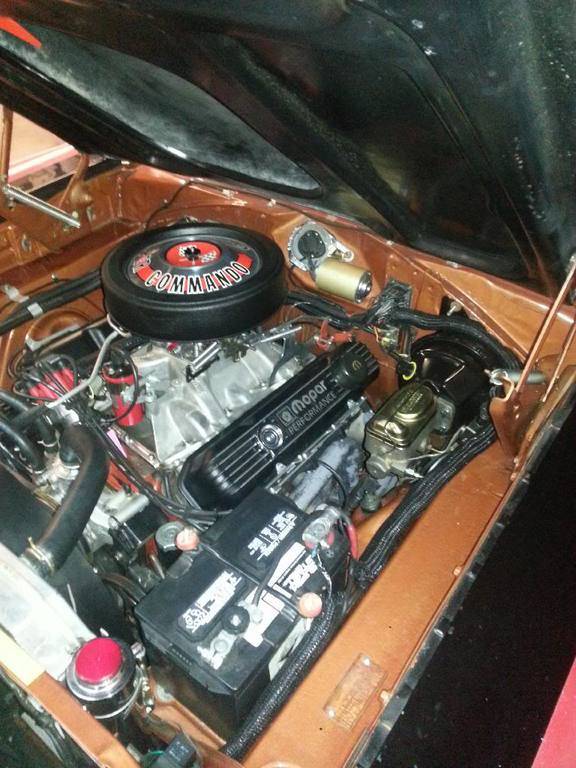

Older pic of mine on the eddy air gap rpm with the ARE bracket.
