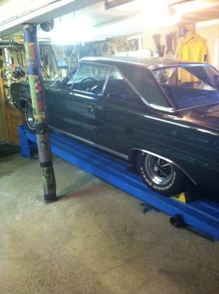

Purchased a lightly used kiwi-lift advertised on Craigslist...just in time to pull the "flanged" 4 speed from my 64 SF and replace it with a "slip yoke 4 speed". I'm sure other members have a similar lift...will let you all know how it works out.

Interesting unit , sturdy feels safe do you put stands underneath to be sure ?

the lift is very sturdy & I do feel safe. But never safe then sorry, so
I do place stands at the front & rear...
there good and I see them on craigslist a lot around here around 500-700
I paid $500.00.
Have seen them advertised between $650-$1,500. When I saw this one advertised at $500.00 I immediately called the guy and told him I was on my way. It was on Craigslist for about 12 hours....(mostly night time).
It does "break down" in pieces and is easily hauled in a pick up. I have a short bed Ram.

I'm not being facetious here, but can someone explain the benefit of these "lifts", please?
It's a raised ramp to get the car off the ground 20 inches that is easily stored or driven on to .
I like its versatility .
Better than just jack stands .
A hoist still is the best option if you can .
I had one for a few years. It was a very good option when you have a standard garage ceiling. Extremely sturdy.
