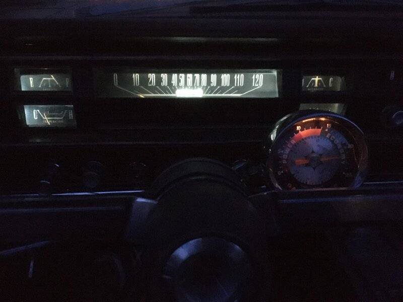

The 3Ks look like originals, I tried the 4.1Ks they look a bit too blueish.

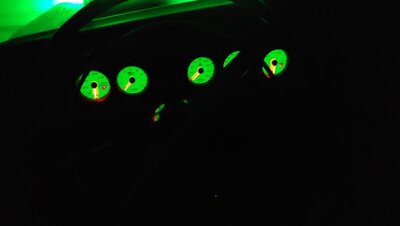

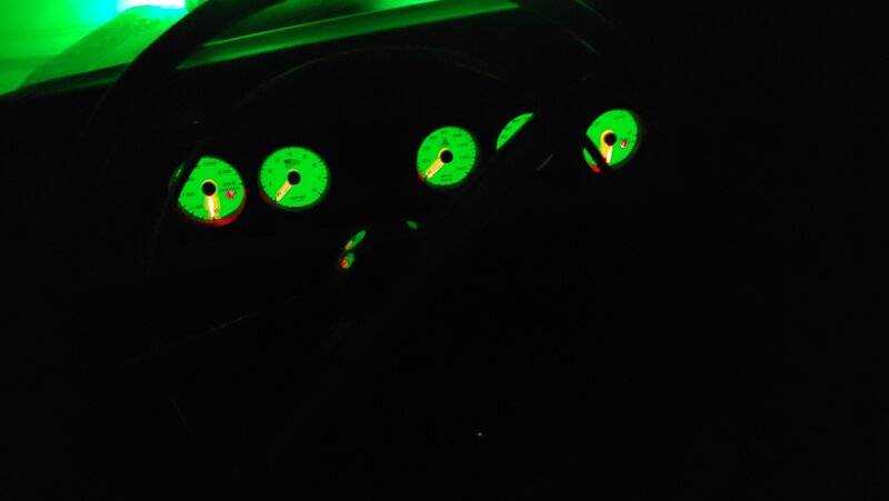

Not sure if yours are are the 194, I bought mine off of ebay,Amazon. I went with the green as I don't like white light at night, bothers my vision.

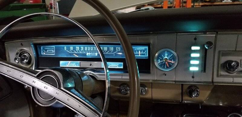

I recently changed ALL my lights (except headlights) over to LED's (can't find them yet). SuperBright has all of them. Worked great and the results were awesome! I used the whitest ones (like 5000K if available). My interior lights looked very yellow before are extremely bright now without changing my lenses.

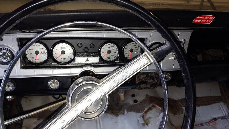

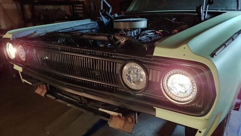

Octane lighting has headlights with Halo rings for the 65 coronet, installed on mine. Also customized the dash with new gauges, green lights to match the exterior. Be sure to get the relay harness for the lights to avoid the flickering you will get with Halogens.
