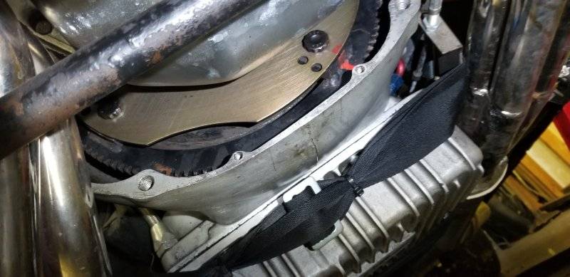

Ok, so Im not quite clear.
I have a B&M B&M flexplate (10235). It has the notch out of it....does that mean it's a blanced flexplate and a neutral converter (it's a 9.5"Dynamic).
Short answer, yes. If there's nothing else going on ( mid plate, spacers, etc) it should work in the 440.
But you say it's a 360, and that appears to be a 340 flexplate . Strange, and unrelated to your initial question.
